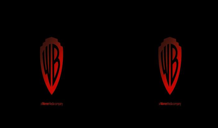

      I took a 4K/HDR10 MP4 video and converted it to a 4K/HDR10 MKV video. The converted MKV video actually has two videos side by side when played. See attached.
      Any idea as to why this would happen?

        It seems like you have picked an mvc profile. Please zip the log files to us, we need to check them first, thank you.
          Yes, I don't know what went wrong the first time (actually took 5 hours to convert), but additional HDR conversions came out just fine.
