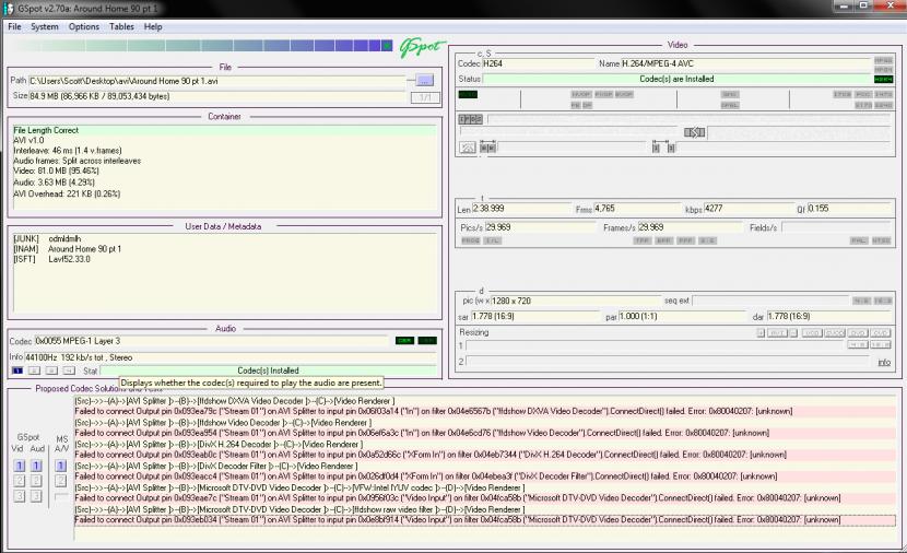

                    I uninstalled the xvid installer and installed the codec pack you recommended. Still no luck. I have attached an image from gspot showing an error when trying to play the dvdfab converted file. I really don't know what I should attribute this to since i have some other avi files that I converted a few months ago using a different converter and they work fine. It's also odd that wmp doesn't show any prompt or error when playing them, it just acts like they are audio files essentially - even when no codec packs were installed.
                    Thanks again
                      I realized that I had uploaded the h264 gspot image rather then the divx one that I have been referring to so here that one is - although it really doesn't make a difference since neither one works. I am about to throw in the towel (and I was looking forward to the lifetime license on this baby) but it's just not working out. I had thought the new beta version had fixed the resolution issue (where the max it shows is 400x450 even if the source is 1280x720) but it looks like it hasn't. Every time I open the program, I never know if it is going to show the correct resolution or not - about 25% chance it will be right. WMP is still unable to play these converted files and I am not finding much online with respect to the errors shown in gspot.
                        Well, had a breakthrough. uninstalled the forementioned codec pack because after looking online some more I found sharks codec pack which actually refers to 64 bit codecs. Restarted after installing and all the converted videos play perfectly! Now if I can just figure out this resolution issue. Looks like dvd fab may be the one after all
