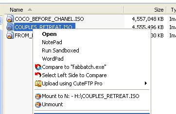

        Process I just tried:
        1. Started PDVD9
        2. Mounted 1st image (COCO_BEFORE_CHANEL.ISO), startd playing fine
        3. Mounted 2nd image (COUPLES_RETREAT.ISO) vdrive.exe hangs and had to kill via taskmgr.exe
        See attached images
        Notice in the Folder_Context.png image is shows COUPLES_RETREAT.ISO, now look at PDVD9_Open_Play_Context.png, it still shows COCO_BEFORE_CHANEL.ISO as being mounted. It's not dismounting properly in PDVD9

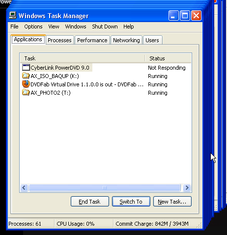

            PDVD9 hangs, did you view the two images, see how PDVD9 won't release the 1st image ? ?
            I will test the via the tray and let you know in a sec !!
            EDIT: This time when I used the tray service icon it at least played the the 2nd ISO and updated the title bar at the top of the PDVD window.... But when I selected a third ISO (which actually was the 1st ISO again) it hung .. See Attached.

              Yep still hangs and vdrive seems to hold onto the 1st mounted ISO ... I knew this because I couldn't edit the 1st ISO's file name. Had to use a tool called Unlocker or kill vdrive !!!
              see attachments.
