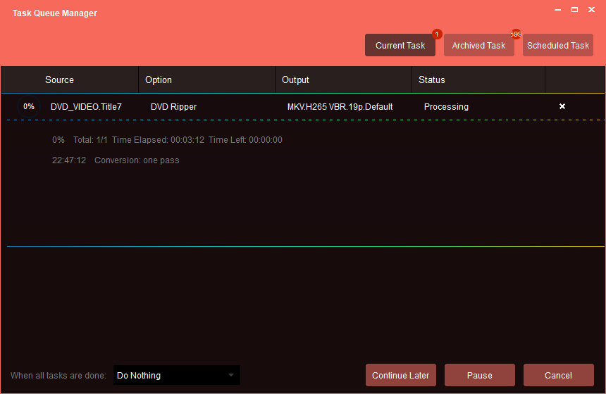

    DVDFab: When I load up the non-PathPlayer ISO from Passkey, DVDFab (with PathPlayer enabled) only shows two of the three episodes from the disc. If I turn off PathPlayer in DVDFab and then load the ISO, DVDFab then sees all three episodes. HOWEVER, the episode that was previously omitted when PathPlayer was on now fails all attempts at encoding, timing out after half an hour. The other two episodes on the disc, however, encode just fine. I should also note that if I click the play button on the title in DVDFab (not the job list but in the DVDFab interface), the episode plays just fine.

    I also found that the problem appears not to be with the encoder but rather DVDFab itself: importing the ISO into DVDFab and creating a passthrough job fails just like any other attempt to render the title - the job just sits at 0% before timing out after half an hour.

        No improvement in v10.2.0.0 - with PathPlayer on, one or more episodes (on every disc) are excluded; with PathPlayer off, episodes that were previously not visible with PathPlayer on refuse to encode.
