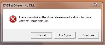

    I'm getting a startup error message when running DVDFab...it has been doing this since the previous program upgrade. I'm not 100% sure when it started though.

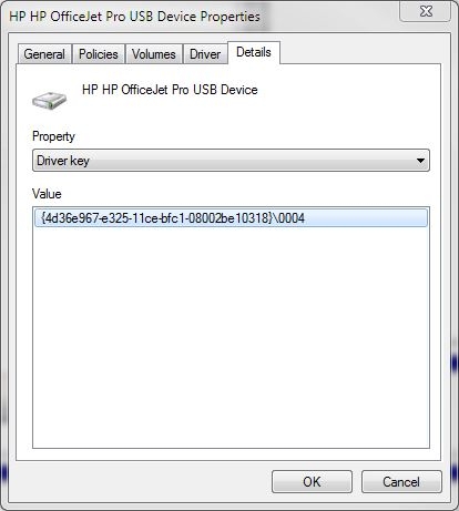

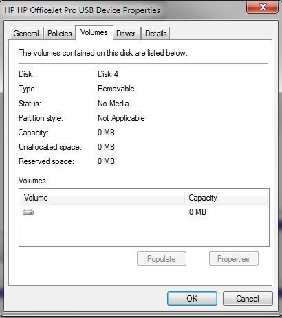

          Thanks! Disk 4 according to the 'Disk Management Tool' is the USB flash drive port in my HP Officejet printer. The program for some reason expects there to be media in that drive. The USB drive port is enumerated by the USB driver for the printer and is reserved and assigned as drive 'E' in the windows environment, even though there is no media plugged in it. The question for me is why does DVDFab expect there to be media in that USB port? I have never put a flash drive in that port.

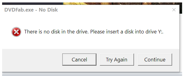

              I now recall getting the same error back around March of last year. After digging through my old email threads to DVD support staff, I located this issue. My issue was with a multi-format card reader with four slots to which I had assigned 4 drive letters as W:\, X:\, Y:\ and Z:\ . I believe I simply hit the Cancel button and Fab would continue loading but was still as annoying as hell.
              Click image for larger version  Name:	Capture.PNG Views:	1 Size:	17.1 KB ID:	357937
              After several emails of suggestions back and forth with DVDFab support staff, (non of which worked), it appears that I finally solved the problem simply by uninstalling the device through Device Manager, rebooting the computer, and letting Windows reinstall it. At least that is what I replied in my email to support staff as the way I solved the problem. and I do not recall getting this error since then.

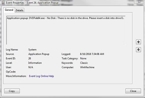

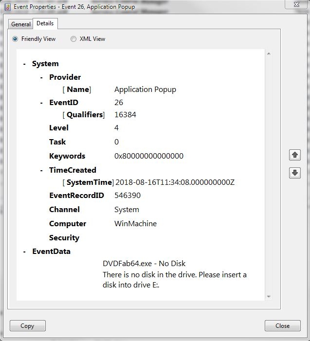

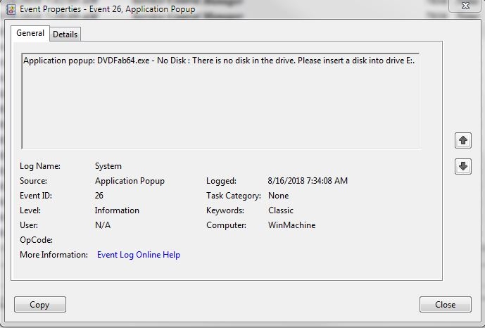

                        If the logs don't provide a clue as to what the problem is then I'm not sure what other info I can provide. Attached are all the logs created by DVDFab, one is a program startup without a USB flash drive and then another with the flash drive inserted.
                        Log.zip
                          ...attached are screen grabs from the Windows >> System event log entries after those two startups!

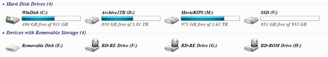

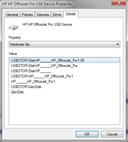

                            The only thing that distinguishes the USB port on the printer from all the other USB ports on any given computer is the fact that the printer driver installs this port as a 'Generic Disk', that is the reason why it shows as a drive letter even though it isn't populated with media. The larger question is why does the program even care if there is media in that port. The other USB ports on this PC are present on the system through the chipsets hub and motherboards driver. Attached is a screen grab of the 'Computer' view, drive 'E' is the USB port on the printer and it has no media plugged in to it.
