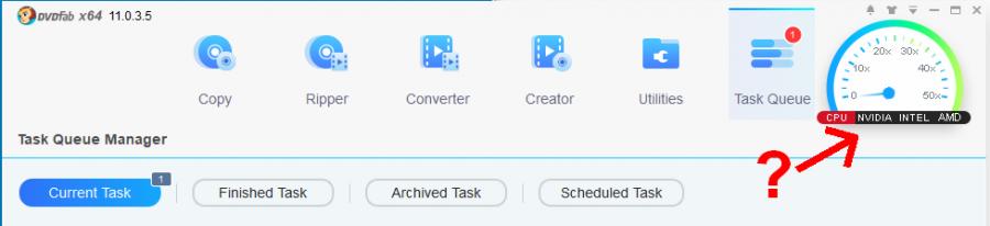

What is this UI element for?

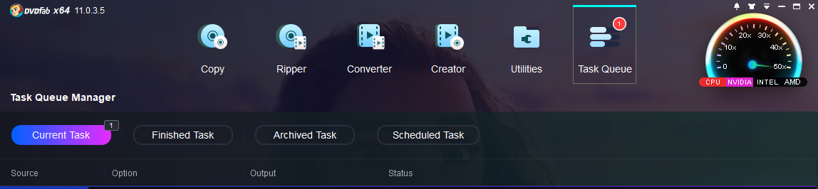

    Apparently it does nothing, or is it supposed to move or something?
    It is dynamic and the best I can gather, it will show you the overall throughput of the current operation (disk read speed + decoding/encoding speed via CPU + Nvidia or Intel or AMD graphic chip). It will only show a speed during actual encoding/decoding operations, not when the app is idle. At least that has been my interpretation based on my observation.
      It must not work because I ripped a UHD Disc and it took 14 hours and it never moved yet all 16 cores were pegged on my system.

            I have a GTX 1080ti and my CPU is a Ryzen 1800X with 16 cores and they were all pegged out in System Monitor.
              As you can see in this video capture it's in that 12% phaze for this UHD disc and that meter is sitting at zero but as you can tell from my resource monitor all 16 cores are near if not at 100%. I don't know if you guys configured it to read Ryzen CPU's or not but it's not reading my CPU.

                It's not the percentum of CPU/GPU usage, but the conversion speed and which is used for conversion, and why you not use your 1080 for converting?
                  Because hardware acceleration yields a larger file size than software encoding and I want to keep it as small as possible.
                    Well I tried what you suggested and used hardware acceleration and the needle never moved off of zero. I have a GTX 1080 ti and Ryzen 7 1800X, that needle should be pegged. Y'all need to get that fixed.

                          From developers:
                          1. Your progress in 12% is a UI problem;
                          2. For the UI that shows CPU in the right top corner, it is for showing conversion speed not for showing cpu usage.
                          For example, if cuda shrinking at 100fps, it will show nvidia 4x speed
                          3. Your youtube video showed converter speed as about 4 fps, and cpu usage about 60%~70%.
                          While soft encode, it's based on x265, and this speed for 4k 10bit h265 is around normal speed.
                          x265 cannot use full ryzen resource for now.
                          https://forum.doom9.org/showthread.php?t=174383 (x265 Ryzen discussion)
                          4. we recommend to use gtx1080ti for reencode.
                          In the advanced setting window, there should be a way to set bitrate to encode small size video.
                            From developers:
