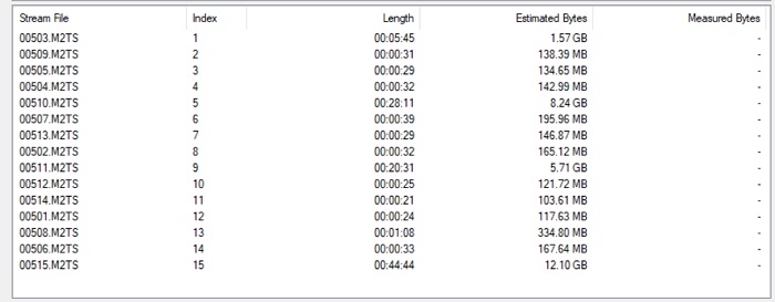

      That is the correct play sequence, find the playlist that will play that sequence of m2ts files.
