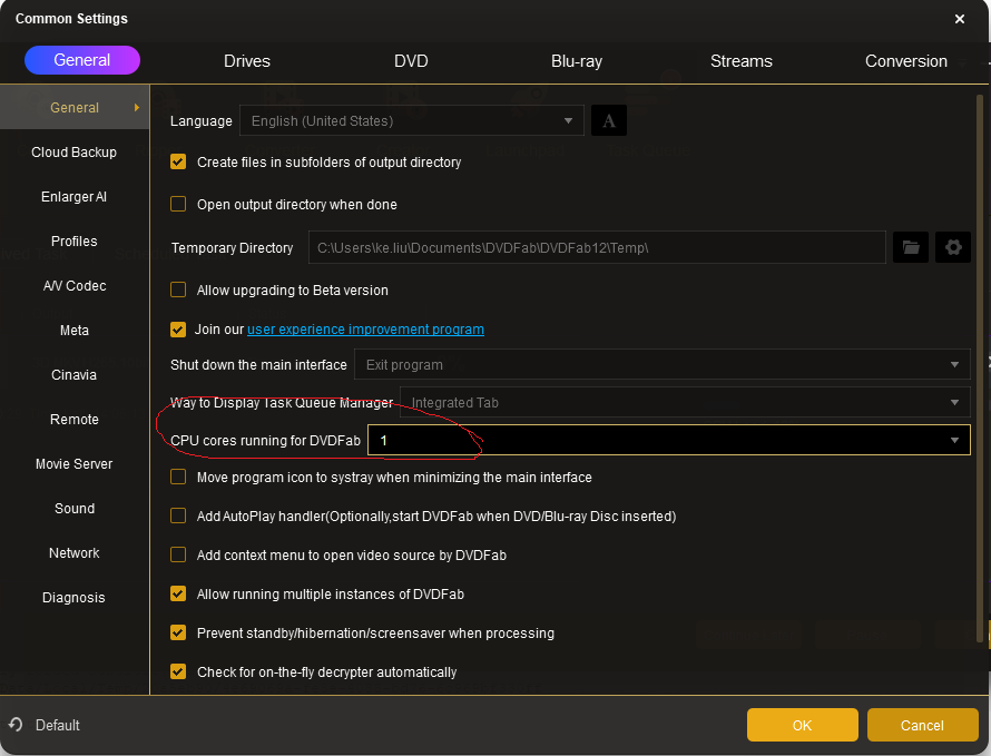

                  We test and the result is good on other cpus. intel / AMD , the current guess is the cpu load or power usage, so please try to use less cpu cores to have a try and see the result. Thanks.

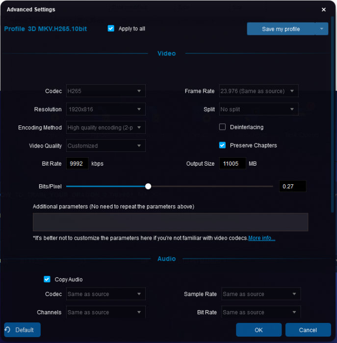

                    I have the same issue with 12.0.0.7 and using one core as a test or any core count does not matter and I can do anything else on my pc that uses upwards of 700w of power from the wall as shown with a ups without any issue. Here is my logs off 12.0.0.7 and some pics showing the settings you showed as well as my conversion settings that just fail and say the task was successful when it has not done anything.
                      Click image for larger version  Name:	CPU core.png Views:	52 Size:	73.3 KB ID:	386768
                      Okay Mona I tried that and nothing changed, I have since then completely removed all traces of the app, registry entry, appdata ect, deauthorized my app first and just completely blew it out and installed fresh 12.0.0.9 and none of my settings had stuck and all entries were created and same issue, here is my must current log from a fresh install and only one file ran which worked in 11. I really do think your H265 10bit encoder is broken, it just always says it can't open the encoder. Handbrake for reference same parameters does work fine. I do really hope this can be resolved or I'm going to have to leave to another app perhaps which I rather not do after using dvdfab for years.

                          Thanks for the advice but the data source is on a NAS and the hdd is in the pc but it has been completely apart recently anyways and this only started happening after I updated to 12 and beyond. I have also already tried that cold boot method too though so it's not that. One pass does seem to work just not two pass.

                              Just a heads up rvcjew, your also cropping your movies. look at your resolution in your advanced settings window you attached. 1920x816. This is a VERY annoying setting that is turned on by default in dvdfab. go to settings and then last tab, conversion, turn off crop automatically. save settings and restart dvdfab. after that the advanced settings will shows 1920x1080
