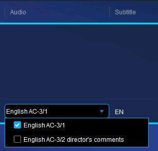

      Not sure if this is to what you are referring, but I did find out how to do what I wanted.​ Haven't had an issue like this before.
      Thank You​Click image for larger version

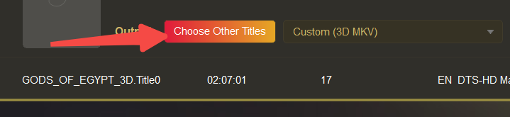

        Originally posted by amd.64 View Post
        Night Court Season 1 Episode 1 in addition to the original episode, the DVD also includes the same episode with commentary by creator, producer and writer Reinhold Weege. Currently DVDFab only wants to rip it with commentary. Anybody know if it is possible to rip it with out the commentary and if so how?
        Please check the other titles panel and find the episode you want and then manually pick it for the conversion.
