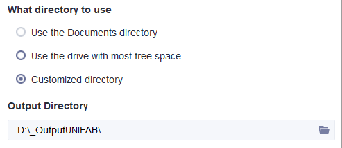

    I then uninstalled/reinstalled UF and I changed the my i/o directories to "_InputUNIFAB" and "_OutputUNIFAB", and made sure to change the output directory in the settings:

    But UF is still saving to the input directory. Logfiles attached.
    I then thought maybe the underscore was causing the problem, so I changed the i/o directories again to "UNIFABInput" and "UNIFABOutput" and made sure to change the output directory in the settings. Same problem.

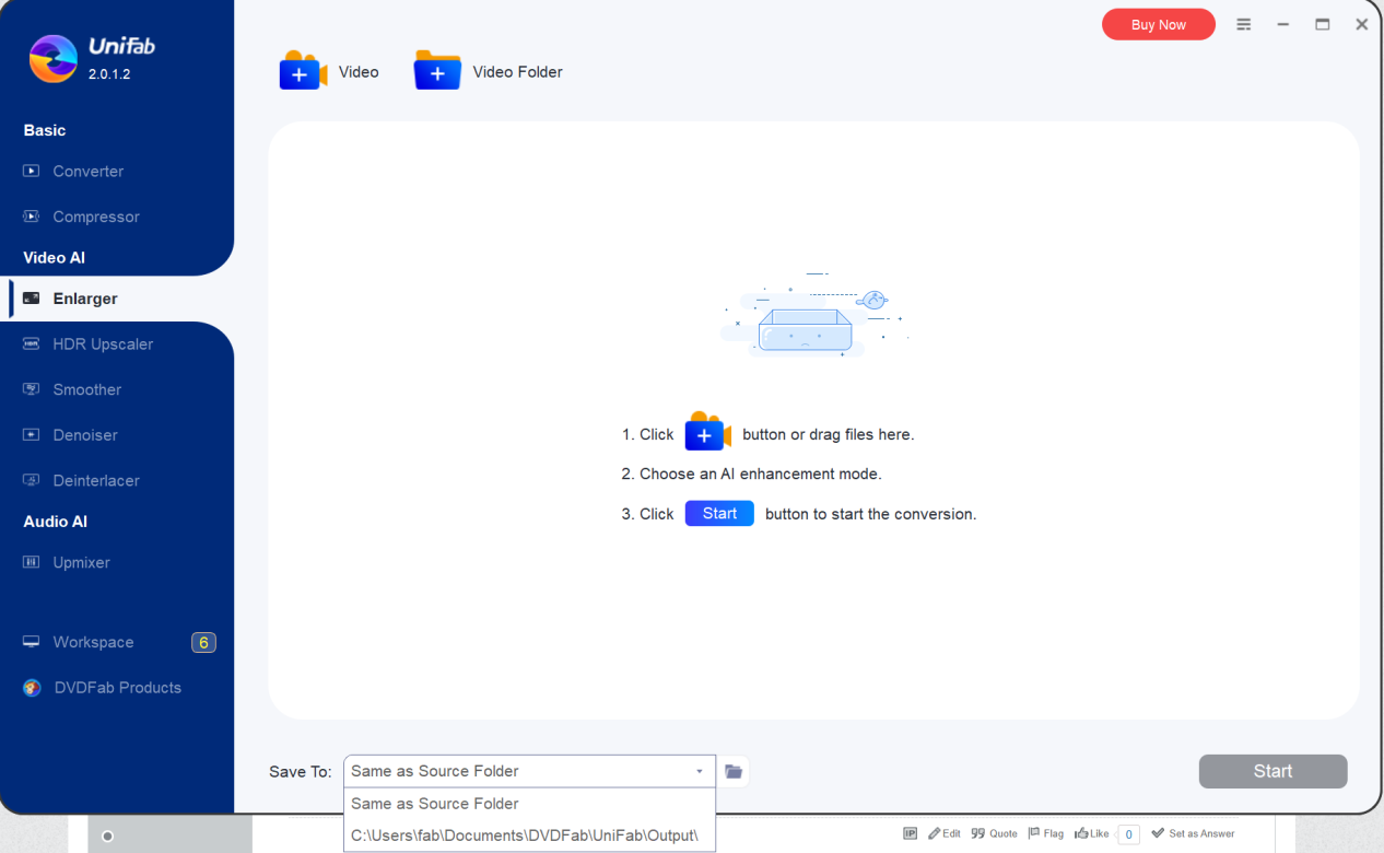

      Hello, there is another option in the module you are using to set the output location. I believe you may currently have the output location set to “Same as source folder,” so I kindly suggest you to switch it. zz0.kwbwcl602f8zzClick image for larger version

        /facepalm I feel foolish for not seeing that. Thank you!
