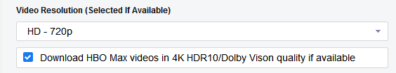

                          While set it like this for HBO Max downloading, it should download the video in 720p if 4K quality is not available. The developer will fix it soon. Sorry for the trouble.
                          Click image for larger version  Name:	screenshot-20211008-163649.png Views:	1 Size:	5.7 KB ID:	400860
                            While set it like this for HBO Max downloading, it should download the video in 720p. The developer will fix it soon. Sorry for the trouble.
                            so when set as 720p in the drop down AND you have Download HBOMax in 4K box checked, It downloads 1080p when 4k isn't available, even though you had 720p selected in the drop down?
                              While 4K is not available for downloading, set it to 720p should download the video in 720p.
                              I didn't notice that I missed a sentence, , thank you for pointing it out. I will modify my original post to make it clearer.
