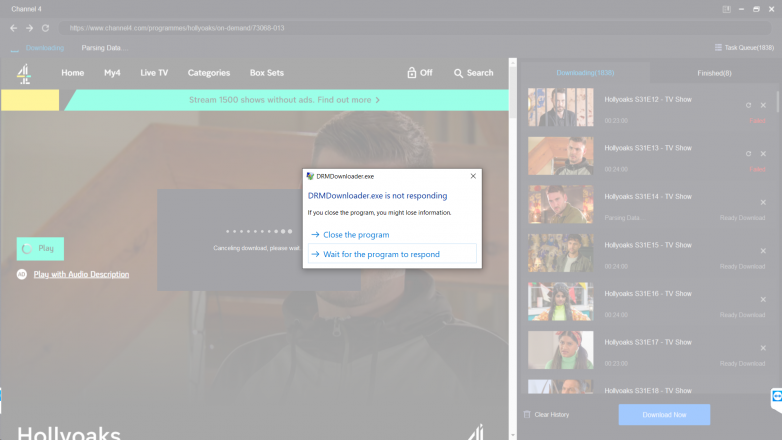

    Having issues again with the channel 4 downloader. I can let it run all night and it downloads about 9 or 10 episodes overnight and finding out it's erroring out a bunch of queued videos. I click the cancel button to stop the queue and close the program only to have it lock up and not respond. I'll wait for long periods of time and it never fully closes. I have to manually close out the interface. It doesn't affect the main program as far as I can see, it only appears to be the channel 4 module itself. Here's the logs and a screenshot.

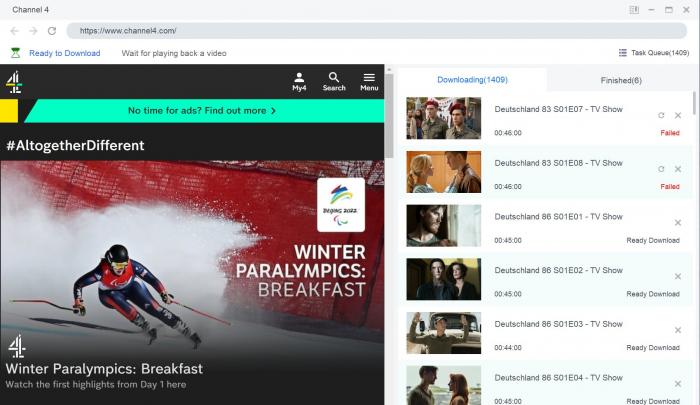

      After the developer fixed the 'audio descriptive' issue (many thanks for that), I'm now having a different issue with the Channel 4 downloader that didn't occur in the original release. This may be the same issue described by @corey75
      Specifically: when downloading multiple episodes of the same series, the Channel 4 module downloads the first episode successfully and copies it to the output directory. For subsequent episodes the module downloads all segments of the programme successfully, remuxes them then fails when it attempts to copy the MP4 file to the output directory and the download is marked as "Failed"

          Same here too. I am in an endless battle with 4.0.2.3 having to close the program and re-open it multiple times for it to properly get an episode or two. Then repeatedly fails after it "finishes remuxing" with a failed message like your image.
