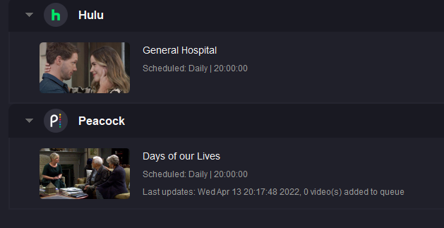

                  I just got done setting up scheduling for my wife's two soap operas that she watches. They start streaming roughly every weeknight at 8pm our time. The key word is roughly. Sometimes it is a little before 8pm, sometimes right at 8pm, and most times a little after 8pm. My concern is that scheduling only offers up times at the top of the hour (ie; 7pm, 8pm, 9pm, etc.) and I don't know what will happen if the task starts at 8pm and nothing new is available yet. If possible I'd like to be able to set my own time for the scheduling such as 8:08pm or whatever.

                      As I wrote in a previous message here that is still listed as "Unapproved", I set up two soap operas for my wife. One is Hulu and the other is Peacock. I've gotten nothing, not even anything added to the Download queue, never-mind it starting.

                      I'm willing to take at least part of the blame for the failure because I fully admit that I'm not really sure how this is supposed to work.
