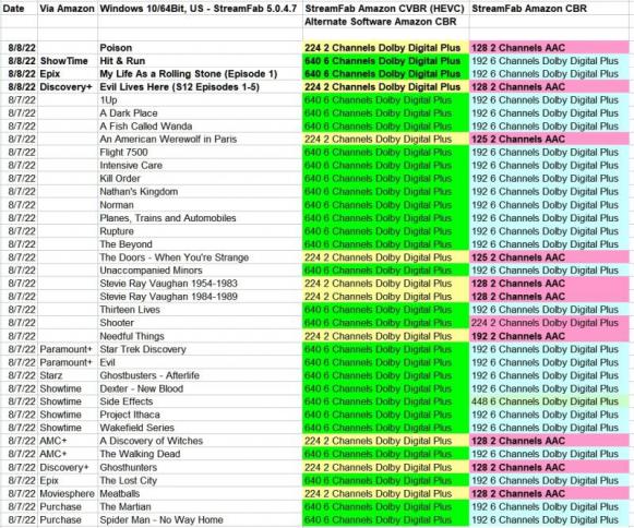

          To me this is a quality issue in audio and does not appear to be spelled out in any documentation on StreamFab's Amazon Downloader Module and their website.
          It only says that a user has a choice of formats.
          In the case StreamFab Amazon module if you choose CBR on Amazon the audio quality is diminished and you don't really have the choice of Audio options.
          I kind of understand that it may be related to coding/re-encoding and only grabbing the standard offered configuration (fixed respecting?) for H264 from Amazon.
          StreamFab currently takes a lot of time in downloading and processing a file and kicks off a "re-muxing" process near the end.
          I don't know how difficult it would be for StreamFab to grab the best audio version and re-combine it in with the CBR/H264 format to produce a better file.
          I do know that the alternate software does not *seem* to take much, if any time, in combining the best audio from Amazon into it's CBR File when it downloads these same files from Amazon Prime, subscribed channels or purchased videos.

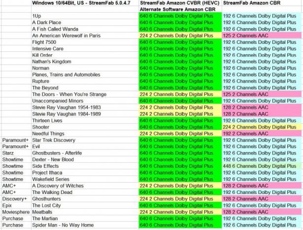

          I spent a lot of time (weeks) revisiting my movies and re-downloading what I think is the "best download option" for me.
          Best for me: Good Resolution/Bitrate of Video and Audio with multi-channel/Dolby/Dolby+
          I also spent time downloading files at least 3 different ways, putting them in a spreadsheet and comparing them for people to consider.
          My main TV/Audio setup has a test emulation mode that emulates multi-channel from 2 channels, but it's *not* as good or enjoyable as having those aspects available in a download, especially in high action films and music offerings for artists.

                              1. Updated to test/dev version and running a test of 32 previously downloaded movies from Amazon and various channels from the same sources.
                              Test of new version:
                              Finished, Video/Audio in Synch, GREAT CBR version!, 640 kb/s 6 Channel Dolby Digital Plus!:
                              Pet Sematary II
                              via STARZ Channel in Amazon
                              Sonic The Hedgehog 2 EPIX Channel in Amazon
                              Time Freak MovieSphere Channel in Amazon
                              Hit & Run Showtime Channel in Amazon
                              Finished, Video/Audio in Synch, Great CBR Version!, 224 kb/s 2 Channel Dolby Digital Plus! - Same as CBVR versions:
                              Black Mountain Side FreeVee Channel in Amazon
                              Modern Vampires Showtime Channel in Amazon
                              Queued up - awaiting results via Amazon Prime, Channels & Purchased
                              Purchased The Martian 192 6 Channels Dolby Digital Plus
                              Purchase Spider Man - No Way Home 192 6 Channels Dolby Digital Plus
                              Epix My Life As a Rolling Stone (Episode 1) 192 6 Channels Dolby Digital Plus
                              Paramount+ Star Trek Discovery (S4E13) 192 6 Channels Dolby Digital Plus
                              Paramount+ Evil (S3E10) 192 6 Channels Dolby Digital Plus
                              Starz Ghostbusters - Afterlife 192 6 Channels Dolby Digital Plus
                              Showtime Dexter New Blood (S1E10) 192 6 Channels Dolby Digital Plus
                              Showtime Project Ithaca 192 6 Channels Dolby Digital Plus
                              Showtime Wakefield Series (S1E8) 192 6 Channels Dolby Digital Plus
                              FreeVee An American Werewolf in Paris 125 2 Channels AAC
                              Discovery+ Evil Lives Here (S12 Episodes 1-5) 128 2 Channels AAC
                              AMC+ A Discovery of Witches (S3E7) 128 2 Channels AAC
                              Discovery+ Ghosthunters (S13E9) 128 2 Channels AAC
                              Moviesphere Meatballs 128 2 Channels AAC
                              FreeVee Stevie Ray Vaughan 1954-1983 128 2 Channels AAC
                              AMC+ Needful Things 192 2 Channels AAC
                              AMC+ The Walking Dead (S11E16) 192 6 Channels Dolby Digital Plus
                              Showtime Side Effects 448 6 Channels Dolby Digital Plus
                              Just Amazon Prime, queued up...
                              The Doors - When You're Strange 125 2 Channels AAC
                              Thirteen Lives 192 6 Channels Dolby Digital Plus
                              Flight 7500 192 6 Channels Dolby Digital Plus
                              Intensive Care 192 6 Channels Dolby Digital Plus
                              Kill Order 192 6 Channels Dolby Digital Plus

                              I can't upload any attachments due to 5 Kb limit (emailed Mona a screen shot) that Mona is looking into, so will post text results and then email Mona a spreadsheet with results.
                              Per Topic:
                              https://forum.dvdfab.cn/forum/softwa...or-forum-posts
                              Mike
                              US, Test Dev Version, No VPN, Win 10/64 (all current updates), Nvidia 2070 Super Graphics Card (latest drivers)
