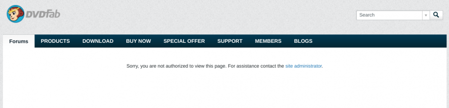

                          The second reason is that I can't personally see the uploaded Attachments like your video or someone's StreamFab.log. When I try to see them I get this...

                          I wrote to the Site Administrator and Mona about 2 or so weeks ago. Mona wrote back and said that I should see it and that she would have the person in charge turn it on for me. I'm still waiting for it to happen. Mona, if you are reading this, could you please look into getting it working again? Thank you.
                                When you got that message, did you log in?
                                We've tried again but we would only get that message when we haven't logged in. I meant could it be that you somehow got logged out without your notice?
                                Click image for larger version  Name:	screenshot-20221008-184045.png Views:	0 Size:	230.4 KB ID:	415979
