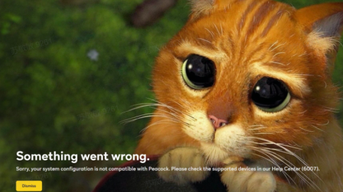

    1. 5.0.5.7 gave me the "Kitty Picture" and said my system was not compatible with 5.0.5.7 when I tried to download Halloween Ends on Peacock.
    2. Exited 5.0.3.7, cleared cache/temp/logs then ran 5.0.5.7 as Administrator an it did not give me the "Kitty Picture" but never started anything when it got to analysis step.
    3. Uninstalled 5.0.3.7, deleted temp, log files, rebooted P.C., installed 5.0.5.7 and it ran fine.

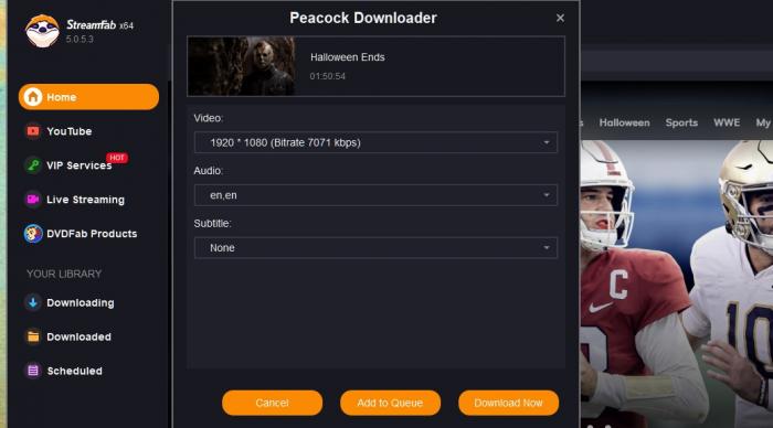

                        2. I'd also advise trying to download the movie from the logon screen, click download now & don't leave that screen - just to test to see if that makes a difference.
                        There is a downloading indicator on the left of the screen (don't click it, it'll just jump off the main screen and go to queue) that indicates a downloading status.

                            About the "Kitty Picture", the developer said that it should not affect the download process, please try not to playback the content through StreamFab browser.

                              Mona,
                              The first time you enter StreamFab and click Halloween Ends on Peacock it starts the download process.
                              If it's interrupted or for some reason (such as Peacock logging you out) you have to do it again you *can't* simply clear cookies and cache and then click the *exact* same thing again, because *that* will attempt to play movie instead of the analysis & download process and you'll get this Kitty page from above.
                              You're actually doing the exact same process the exact same way, but your get the above kitty picture on a second attempt.
                              You have to exit StreamFab & do it again.
                              I'm pretty sure that I've gotten the above kitty screen on my first attempt on initially logging into StreamFab and will make note if it occurs again.
                              When I've gotten this screen I exit StreamFab, manually clear logs/cache & try again which seems to work for me.
                              Don't know if it's the exiting or the clearing of cache though.
