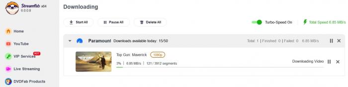

        Uninstalled StreamFab 6.1.0.0, deleted temp/cache/logs & installed 6.0.0.8 from offline version from DVDFab.cn that I have saved.
        It downloaded as 1080p (see attachments)

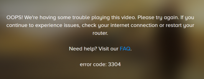

                    Queue was completely empty when I did a total uninstall including registry and configuration. Temp folder and log folder were completely erased. Reinstalled using offline 6.1.0.0, got authorized, setup Settings and tried to get Top Gun Maverick, 1923 S01E01, and an older episode of some other TV show that I can't remember. They all failed with initially a 3205 error which quickly changes to a 3304 error.

                      Let's see if I can get the screenshots of both errors attached to this message. I failed the last try.

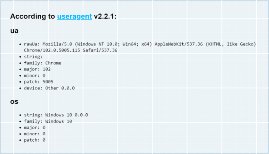

                            If I were writing the code for Paramount+ to check if the browser connecting in is able to handle the new Widevine, I'd check the User Agent. This is the User Agent that StreamFab's CEF browser is showing now...
Name:	Screenshot 2022-12-23 11.16.18 AM.png
                            So, it is saying that StreamFab is using Chrome version 102. Problem - the version number of the first Chrome browser that can recognize Widevine-2 is version 107. The latest stable Chrome browser is version 108 with 109 due out soon. That means if Paramount+ or any other streamer checked the UA to see if the browser (StreamFab in this case) could handle the new DRM then one showing only Chrome version 102 would be rejected. This would become more important if they do follow through with what was originally written, that Widevine-1 would be removed completely.
                              Update: I was able to download from Paramount + after removing the StreamFab program folder and then installing version 6.0.0.8.
