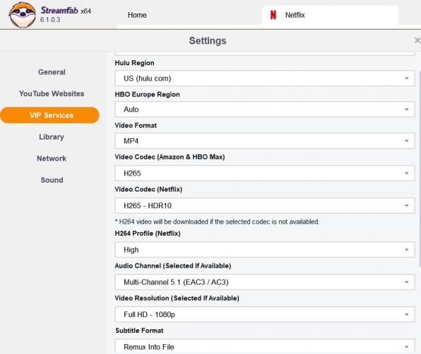

    I assume you need to change the parameters in StreamFab for Netflix (see attached)
    Video Codec for Netflix to: H265 - HDR
    Any other changes I need to make, for H265 MP4 right now?

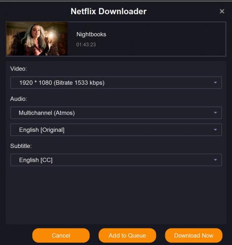

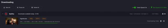

      I Have the premium version of Netflix through my cell provider T-Mobile. StreamFab is successfully downloading H265 HR10 videos.
Name:	Netflix select menu.jpg
Name:	H265 Downloading.jpg

        I set the Netflix profile to High also, is that ok? or should it be Main?

          Seems like adding the Main profile is what allowed them to get HEVC. When downloading to H265 HDR10, it has a Main 10 profile. I downloaded The Witcher Season 1 Recap and Making the Witcher on January 9th when testing the differences between Main and High and i just now realized that they downloaded as HEVC!!!
          I have just now downloaded Bastille Day (The Take), Mumbai Mafia: Police vs. The Underworld, Red Notice, The Irishman and The Pale Blue. I Selected the bitrate closest to 3500. My Profie is set to High.

          So bizarre that new stuff like Bastille Day and The Pale Blue are not available in HEVC HDR10...I might try setting the profile to main and see what happens with those 2...
            Ok so the logic needs work a little bit but for now, if you want to download in HDR10, set the profile to Main. When it was on High, downloading The Pale Blue Eye was AVC and on Main, it downloads as HEVC HDR10.
            It's very weird that the other 3 downloaded as HEVC HDR10 while the settings were on High.
            But the simple fact that HEVC downloads always say Main 10, it's probably safer to choose Main. And to think i at the Main profile before... rotfl
