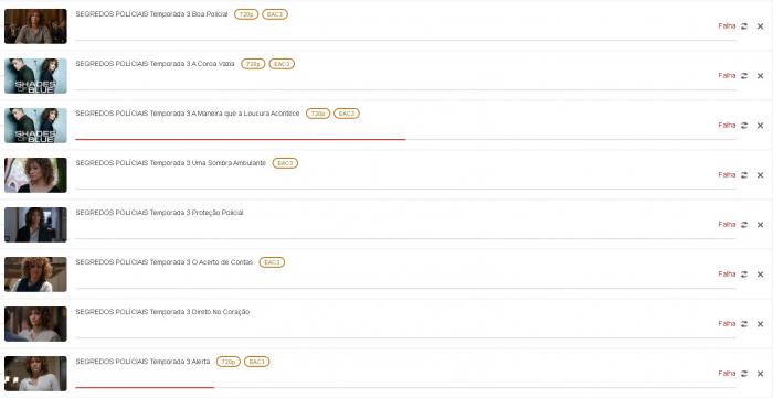

    Now the glitch has occurred in everyone in the task list.
    I hope this topic will get the attention of the software developers. We need a solution.

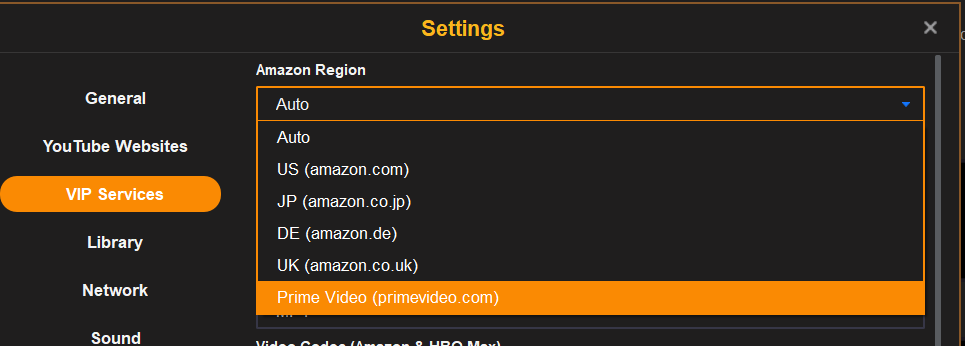

            The log file for v6100 has been passed to the QA team. Meanwhile, just in case though, did you set the correct region for your Amazon in StreamFab?
            Click image for larger version  Name:	screenshot-20230119-152641.png Views:	0 Size:	21.4 KB ID:	421037
            Also, like Cats4U​ said, your case is not the same as the OP.
