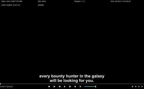

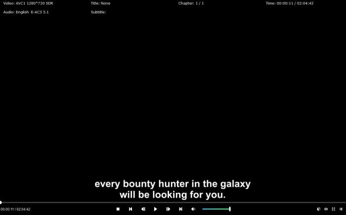

    I've noticed this in several versions going back for a while. For SW - A New Hope, while the forced subtitles are downloaded, when it goes through the remux, the subs all come through in about the first minute of video. After all the years, pretty much know by heart but it's still annoying when watching. Have played back in multiple viewers including PlayerFab. Log attached from most recent version.

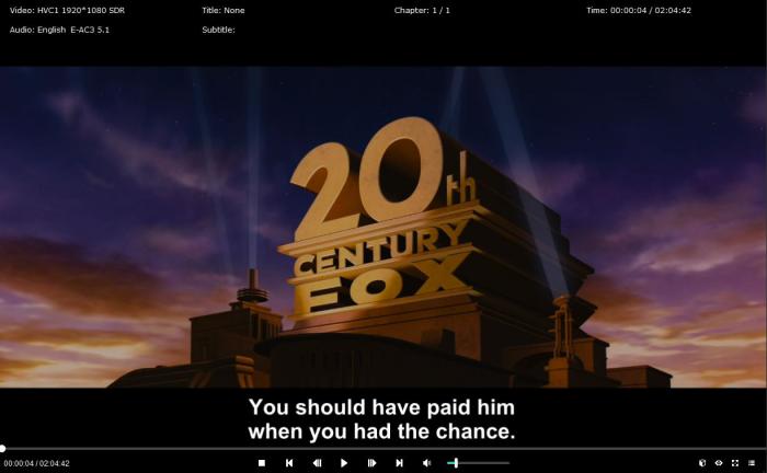

              Also wanted to update that the subtitle issue is also happening with v6.1.2.5 for this title. Didn't really expect it to change but figured it was worth the test to check out 1080/H265.

                      As I mentioned on 6/2, this still seems to happen on the latest version. I went though again and cleaned the queue and in addition, deleted temp files and restarted my pc. I'll attach a new set of logs as well. 2 notes - when I first went to download, it just spun and I had to stop and restart the download. That seems to happen a lot with 6125, sometimes the pause/restart helps, sometimes the whole program needs to be closed. Also the forced subtitles should actually start around 50 minutes into the video. Click image for larger version
