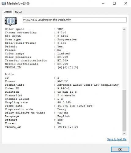

                      I can't view the sample text (don't have permission). So far, there are two PBS series that have subtitles, but are not capturing them: Secrets of the Dead (that I have checked so far) and Finding Your Roots. Here is the mediainfo for Season 7, Episode 10. If there are subtitles, they have the ID # 3.
Name:	FR S07 E10 Metadata -- No ID 3 (subtitles).jpg

                          Interesting. The difference is that I'm saving in mkv format while you're saving in mpeg format. I'll have to give it a try. and also something for the developers to look at.
                          Thank you for posting the complete report.
