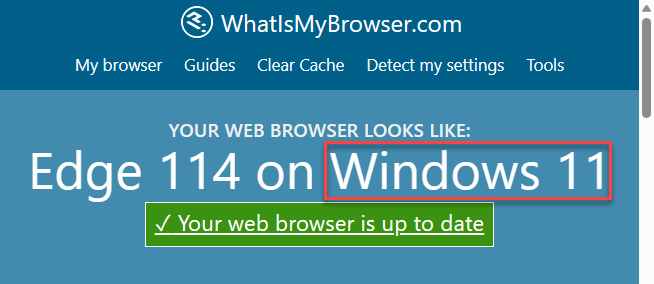

                          https://www.whatismybrowser.com/ probably uses the User-Agent method as it's base. User-Agent always returns Windows 10 for either Windows 10 or 11 for a Windows browser. There is a newer method called User-Agent-Hints which https://www.whatismybrowser.com/ must also use. This only works with a few select browsers (not CEF/QCEF) and is able to differentiate between Windows 10 and 11.

                          I guess it's using the hints
                            Yep, that would be what I would expect. Edge is one of the browsers that can pass that info along and it would make sense for the folks at Whatismybrowser.com to be knowledgeable of that method. QCEF/CEF in StreamFab will return a Windows 10 because it does not do User-Agent-Hints.
