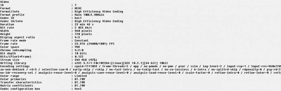

    I downloaded The Fresh Prince of Bel-Air from MAX in 720p for now. I then transferred it to my NAS and for some reason VLC for Firestick will only play the audio but not the video. I thought it was maybe cause it was H265 so I tried another show which was also H265 and it played fine. I tried on my computer and The Fresh Prince plays fine with potplayer without issue. Is there a fix for this that I don't know about yet or is it something that needs to be fixed in general?
    Post the MediaInfo display (text preferably) for the Fresh Prince video and then the other show you tried.

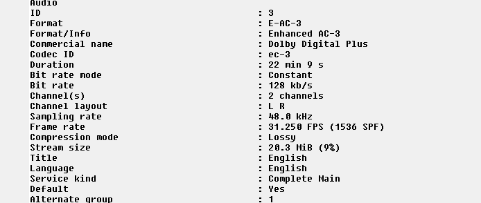

        The first 2 screenshots are from The Fresh Prince and the last 2 screenshots are from Family Matters. I even tried redownloading the files and neither will play video now. Just the audio plays.

          Nevermind I fixed it. I had to turn off hardware acceleration in VLC Player. Now all H265 videos play correctly. Now if they can just fix it so we can download 1080p video or above from MAX. That would be great.
            Thanks for posting that. I'm glad that you were able to fix your problem. I'm just a little curious about your MediaInfo displays though. To me, a few of items listed don't look like anything that StreamFab would produce. I could be 100% wrong but I won't know until I compare it with my own or someone else's examples. Unfortunately I'm unsubscribed from Max at this time, probably for the summer, and so I can't test it myself. Perhaps someone else could do a download of one of the files using the same settings and post the MediaInfo here. Could it be at all possible that your NAS is transcoding the file as it gets put in your library?
              If you are talking about the encoding settings, this is standard. HBO Max was always like this. It kinda triggered my OCD cause it is being detected as x265 rather than h265. anytime StreamFab would produce an x265 file, it was always larger than the same h265 file.
