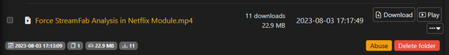

    Because it seems not everyone knows how to do this, i figured i'd show everyone how.
    This method will not mark the episode as the next one to watch like it would if you actually play the episode in your browser and copy the URL from the browser's address bar.
    This instance of VBulletin is horribly configured and there are non-sensical restrictions like the amount of images that can be in a single post. For this reason, i recorded a video instead.
    I had a lot of background noise at my house today so i used the Test-to-Speech engine in Windows for the audio.

    Here is the video...
    Secure, fast and free cloud storage solution. Upload and share files instantly.

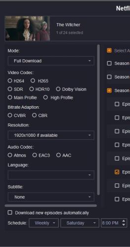

                      Ever seen this control system in SF? Did I stumble on a debug mode?
                      Click image for larger version  Name:	Image3.jpg Views:	0 Size:	18.1 KB ID:	428892
                        This is hilarious. I am very happy they are finally adding that great Amazon Download window to other modules. I will hunt down bugs without being snarky cause i will be happy!
                        When i say hilarious, it's because i entered this as a feature request on the upcoming bug tracker i am working on
