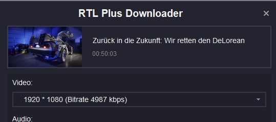

    I already thought about that. But that would also be partially illogical. Because it is only partly like that. A few more facts from me. Maybe they'll help!
    1. I was able to download this movie correctly with the high bitrate 14 days ago.
    2. I downloaded the series CSI Cyber with 2 seasons. Season 1 was ok with the high bitrate. Season 2 with the low.
    3. RTL + has taken some episodes of its own TV shows and reality shows offline. The reason is that you first have to recode for the new player on the new website, then they will be uploaded again.​
    I'm connected with 110 Mbit/s and tested with slower connections..
    never got the 7800k cbr mpd in browser and always the same vbr mpd
    I think it has changed bit by bit since last month, when api.tvnow.de was shut down.​
    So there you go Sebastian001. You have your answer. RTL+ made changes. It's not due to your network speed or StreamFab. Looks like they are moving away from the High@L4 CBR profile and moving towards the Main@L4 VBR profile (Which is more widely supported by players/hardware) it's probably a gradual thing.
    The people behind the tool Germania is using figured out the CBR .mpd file is static apart from the video id and that is what they use to download the "better" version. I put better in quotes because people need to understand bigger does not mean better in a lot of cases.
      Log.zip
        If it was a DRM change, you would get nothing. 4987 kbps is quite an acceptable bitrate. Bitrates have less effect on quality than most people think. Bigger is not always better and can sometimes make quality worse.
          Well, you may be right. you sometimes hear that 2160p doesn't have to be better than 1080p etc...
          But that's not what it is about.
          I don't want to put the problem into perspective.
          It must be checked whether it is due to Streamfab or whether the videos actually only have this bit rate. I paid for it too. :-) The result of the file is even lower. She only has around 3xxx. The same problem was also checked on Max a few days ago. It was also about bit rates, which were suddenly much lower.
          I even have a series that only wants to load 720p. Although it is actually supposed to be available in 1080p. So there must be something hidden.​

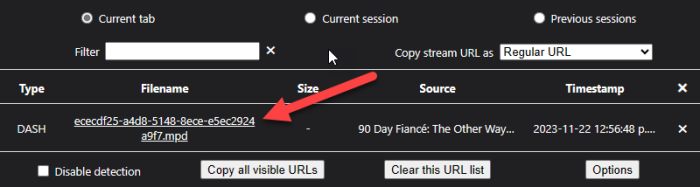

                For users who don't know how to find the manifest file, download it, open it and format it in a "readable" format, you can use the YoutubeToMP3Process.exe to list the available formats.
                Here is how to do it:
                In a Chromium based browser, install and enable .
                Go to the media you wish to analyse and play it.
                The icon for The Stream Detector will show a number for the amount of manifest and/or external subtitles it finds
                Click the icon to open the dialog
                Right-click ​the filename and copy the link

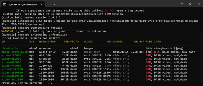

                On your PC, open a command prompt and navigate to C:\Program Files\DVDFab\StreamFab\YoutubeDL
                Run the command:
                Code:
                YoutubeToMP3Process.exe --allow-u -F TheURLYouCopiedFromTheStreamDetector
                This will list all the formats available for that video, based on that manifest file.

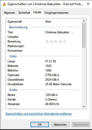

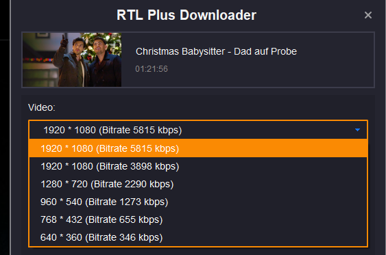

                        Thanks in advance, I'm still trying out your instructions...
                          I managed to save your code in a text file. After opening, the program asks me for the link and whether I want to take 1 or 2 for analysis. I take 1 the program runs and closes straight away. It happens so fast that I can't read anything. This is my example file. Maybe someone can test it with the URL.
                            Here's how Stream Fab shows it and this is how the file actually comes out.

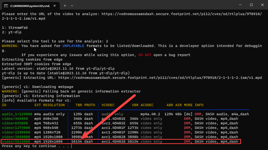

                              If it flashes then that means you don't have the pause command at the end of the file. Make sure you copied the entire text.
                              As for the results, we get the same bitrate with StreamFab and yt-dlp so there is no problem with what StreamFab is showing.
                              One thing i find odd is the URL of the MPD file. It's in a folder named sd which is weird. Also having v1.mpd makes it look like there would be a v2 maybe? I tried v2, v3, v4, and v5 and they all show the same info.
                              Trying with hd instead of sd returns a 404.
                              Since you got the mpd file from your browser, it's clear it isn't because of a DRM change as your browser always uses the latest CDM required.
                                The sd mpd you/streamfab used is for non premium accounts.
                                For full 7800k this mpd is correct:
                                https://vodnowusoawsdash-a.akamaihd.net/p112/streaming/watch/978910/11-10000-1-1.ism/.mpd​
