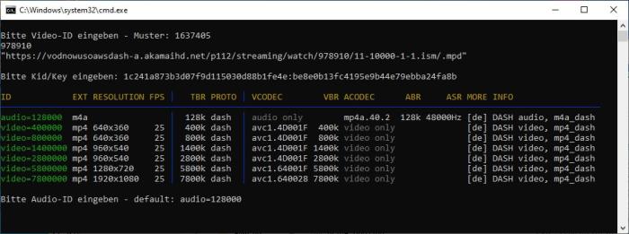

Judging from Germania's screenshot, they are using a tool where you put in the id of the video and it will get the appropriate MPD and extract the decryption keys.
So i tried using the URL
And sure enough, it gives the higher bitrate.Code:https://vodnowusoawsdash-a.akamaihd.net/p112/streaming/watch/935946/11-10000-1-1.ism/.mpd
I am wondering if the site detects your network speed and serves you this MPD because that is the maximum bitrate it deems would work for you without buffering.
Also, that MPD uses constant bitrates while the one StreamFab gets uses variable bitrates.

So there you go Sebastian001. You have your answer. RTL+ made changes. It's not due to your network speed or StreamFab. Looks like they are moving away from the High@L4 CBR profile and moving towards the Main@L4 VBR profile (Which is more widely supported by players/hardware) it's probably a gradual thing.Originally posted by Germania View PostI'm connected with 110 Mbit/s and tested with slower connections..
never got the 7800k cbr mpd in browser and always the same vbr mpd
I think it has changed bit by bit since last month, when api.tvnow.de was shut down.
The people behind the tool Germania is using figured out the CBR .mpd file is static apart from the video id and that is what they use to download the "better" version. I put better in quotes because people need to understand bigger does not mean better in a lot of cases.
