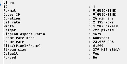

    I wanted to bring up an issue I've been encountering with the Amazon module since the version, 6.1.5.1, of StreamFab.
    Recently, I've noticed occasional problems when downloading videos from Amazon. After the download, the video or audio is sometimes outputted as a QuickTime file, making it unplayable.
    Click image for larger version  Name:	bX2cDJe.png Views:	0 Size:	5.0 KB ID:	433609
    While re-downloading the content can resolve the problem, it's frustrating that we have to double-check everything each time to ensure a correct download.

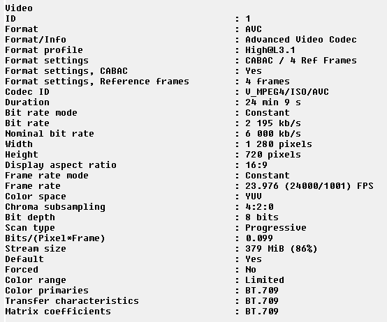

    This is the correct one:
    Click image for larger version  Name:	voEWfsg.png Views:	0 Size:	11.8 KB ID:	433610
    What makes it more challenging is that the issue is difficult to reproduce since it seems to occur randomly.
    Has anyone else experienced similar difficulties since updating to version 6.1.5.1?
    Just in case: i use 6.1.5.2
