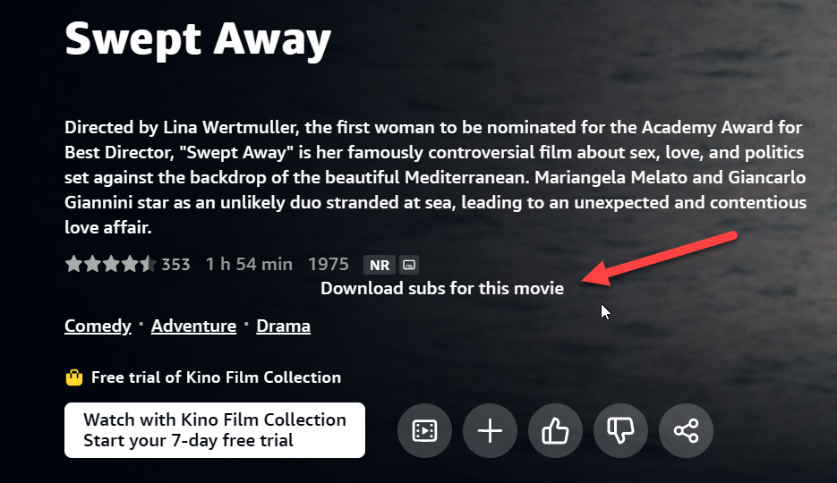

      If none of these work, we need to get you those subtitles before the end of your trial. I am not sure how tech savvy you are but i will tell you how to get them and hopefully you can figure it out.
      Using or , use this UserScript to add a link to the movie's page to download the subtitles.
      Basically you install *Monkey in Chrome or Edge, then navigate to the userscript and click install this script. Then, you go to the movie's URL and you should see a link to download the subtitles for that particular item.

      Hopefully it will find the subs and you can remux them into​ the video file StreamFab downloaded. I cannot test it now as i don't have access and want to keep the 7-day trial in case the devs need me to try things.

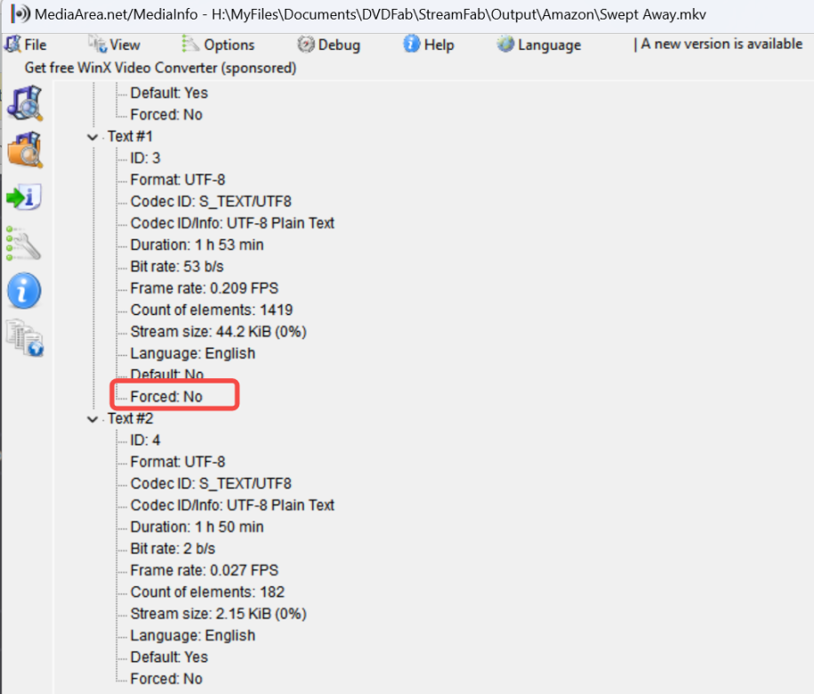

        * MKV [FFmpeg], both forced subtitles and English [CC] selected: no forced display, but [groans] [screams] and [shouting] did show up when either character yelled in Italian
        * MKV [FFmpeg], forced subtitles only, no forced display, and no [CC] [shouting] etc. indicators
        * Back to MP4. Extracted subtitles to SRT and got a separate en-us_cc.srt file and a separate en-us_forced.srt file.
        * Already tried 1) forced subtitles only 2) English [CC] only 3) both together and finally 4) neither selected, last night, no selection worked
        I'm middling tech-savvy if the wind is blowing right and I have a lot of caffeine on board, so let me know what you have in mind to obtain a forced-subtitled version. I'm game.

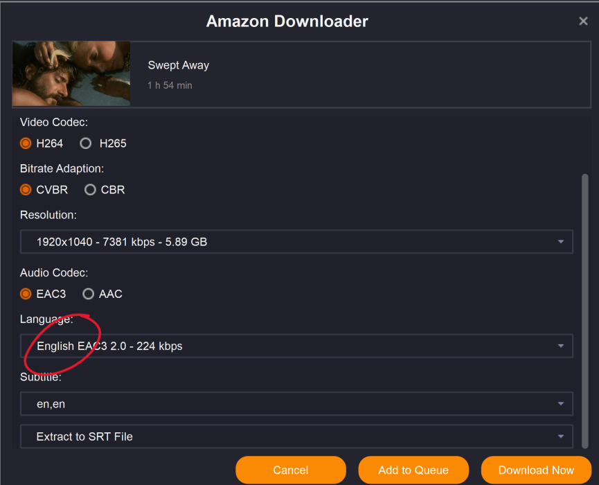

        *** I just noticed that SF identifies the audio track as English - not Italian. It explains MediaInfo's mis-identification, but could it also be why English forced subtitles wouldn't display - i.e. the SF software sees that as either unnecessary, or as a conflict?
        Click image for larger version  Name:	Screenshot 2023-12-04 14.23.23.png Views:	0 Size:	105.3 KB ID:	433707

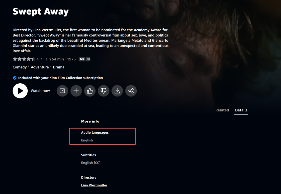

                              For the audio language problem, it's not the bug of StreamFab, it marked as English by Amazon.
                              Click image for larger version  Name:	screenshot-20231205-120950.png Views:	0 Size:	347.6 KB ID:	433731

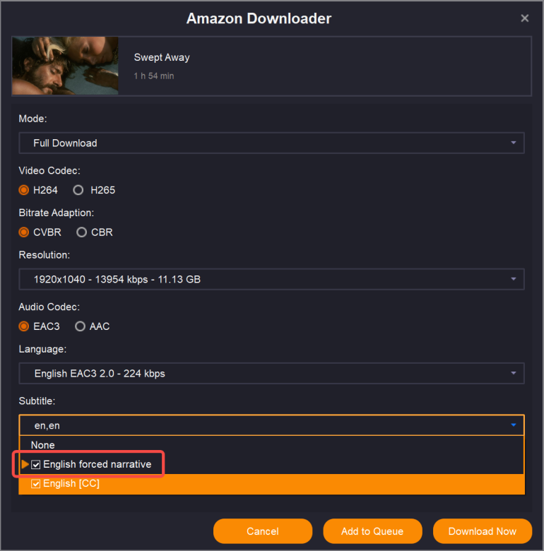

                              For the subtitle, you can set the forced subtitle as default play back subtitle when downloading the video.
                              Click image for larger version  Name:	screenshot-20231205-120916.png Views:	0 Size:	95.9 KB ID:	433732
                              And for the forced subtitle flag, I will ask the dev to check it. But the forced flag can be supported only when download as MKV with MKVToolNix.
                              MP4 and FFMPEG don't support it.
                              Click image for larger version  Name:	screenshot-20231205-121307.png Views:	0 Size:	210.3 KB ID:	433733
                              If you want to correct the audio language and add the forced display flag for the subtitle, you can use MKVToolNix to correct it.
                              Click image for larger version  Name:	screenshot-20231205-121557.png Views:	0 Size:	156.1 KB ID:	433734
