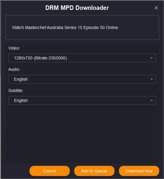

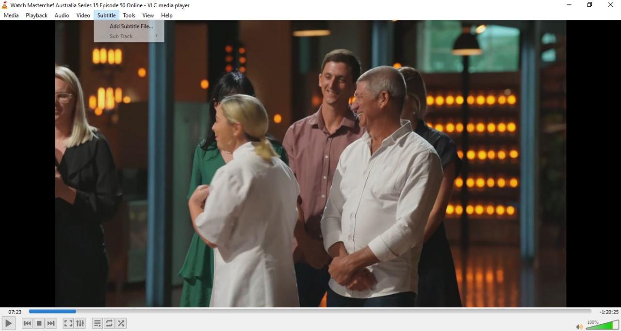

    I am selecting subtitles on UKTV but not getting them. Screenshots and log attached. I tried Masterchef Australia S15E50, Casualty S1E1, The Block Australia S18E1.

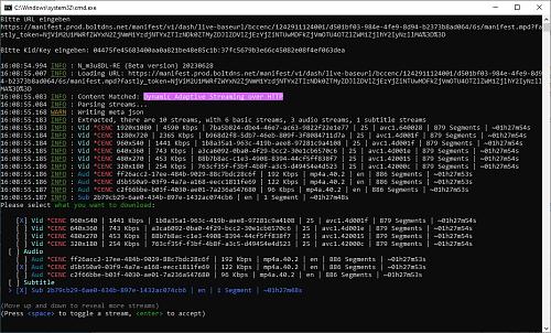

        SF downloaded the sub but don't extract in output.

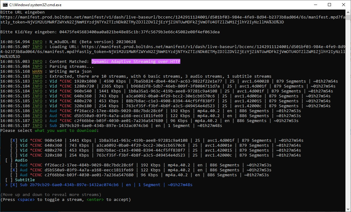

        I don't see subs in Browser - but there is in Manifest ..
        i.e. Masterchef Australia s15e50

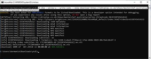

        Temporary Workaround - You can dl it without key:
        yt-dlp --allow-u --write-subs --skip-download URL
        Example​
