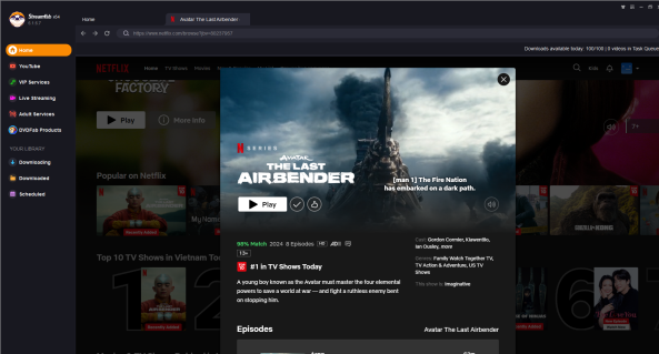

    I tried it, it's the PC version and of course it can't be analyzed Click image for larger version
      Did you try logging out and back in again? If that still doesn't work, try clearing your cache and final resort is complete uninstall (preferably with professional uninstaller) and re-install

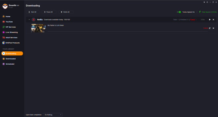

            I followed your instructions and it analyzed successfully. but still cannot download. Thank you for your enthusiasm in spending your time with me. I just need audio but it won't download. Click image for larger version
              "My Name Is Loh Kiwan" released March 01 - info
                You're welcome. This is expected behaviour. You cannot download anything that was posted after January 25th. The addendum was really only about not being able to analyze anything. Old or New.
