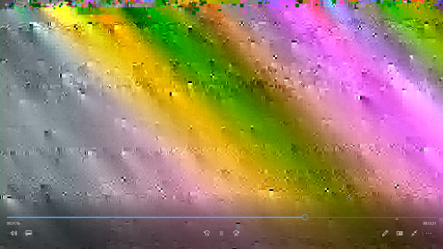

    So, after getting help downloading subtitles (which were previously missing), I am now faced with another problem.
    With Youku, after downloading a show successfully (at 1080p), when I go to watch it, the timestamp gets to 1:41 and then the screen completely pixellates. This is the same regardless of which show I download.
    Is it because the website isn't supported? If that's the case can I do anything to rectify the issue? or do I just have to sit tight and wait for the website to be supported at some time in the future?

          Ok, I am now using 6.1.6.7 and have the same issue. Show starts fine, reaches 1:40 on timestamp and pixellates for the rest of the duration of the show. If I've done this right, my SF log should be attached.

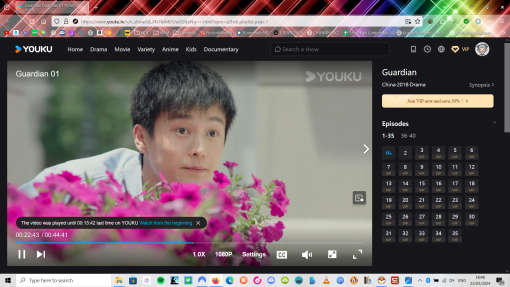

                Yes, I am a VIP user of the website. I'm logged on both on my browser and via SF. I am able to watch the show on the browser without issue.
                Edited to show screenshot of show playing in browser at 22mins, and VIP status (1080p)
