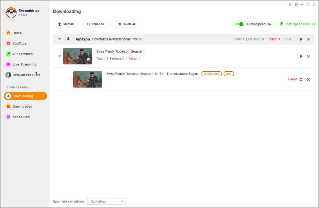

    Following advice in another thread, I deleted my C:\Program Files\DVDFab\StreamFab folder and the designated TEMP folder, rebooted and then reinstalled StreamFab 6.1.8.1 64-bit using the off-line installer. Also emptied my download queue. Unfortunately, subtitles are still not being remuxed into the final MP4 file. When downloading "Subtitle Only", The "Extract Original Format" option succeeds and produces a TTML file. When "Extract to SRT File" is selected, the download fails.

            I thought I attached the StreamFab.log to my first post, but it's showing now as "[ATTACH]n443591[/ATTACH]". Does that mean a mod grabbed the log file or it did not get properly uploaded as an attachment?
            To summarize, I am able to download subtitles as TTML files using "Subtitle Only" and "Extract Original Format", which I can then manually convert to SRT format and mux into the MP4, but am not able to remux them or download in SRT format using StreamFab.

                      Watching the outputTemp folder, where the program assembles the downloaded streams, one of the first temporary files that the program creates is "0." in the Sub_00 folder (subfolder of Period_00, which is a subfolder of a temporary folder under the temporary Amazon folder). This "0." file is the subtitles in TTML format. With "Extract Original Format" selected, during the remux stage it is copied to a file named st_00.ttml in the same temporary folder. Unfortunately, it is deleted with the rest of the temporary files instead of being moved to the permanent output folder (but if Subtitle Only is the download option, it is copied to the permanent output folder). So the program has no trouble extracting the subtitles from Amazon in TTML format. To remux them into the MP4 file, it needs to convert the TTML file to an SRT file. That's the step that fails. The "convert result subtitle" routine is invoked 3 times and fails each time. The error message says "transformXmlToSrtSubtitle failed". With a zero-length or nonexistent SRT file, the RemuxMultiAudioSrtMetadataUtil call, which appears to be a wrapper around FFMPEG.EXE, is called without a subtitle input stream.
                      Code:
                      2024:06:08-09:29:39 0x00003010 [Info]: convert result subtitle file d:%5CM%5C_IN%5CTEMP/outputTemp/Amazon/2024_06_08_09_26_55_B0CH8X4FKG/Period_00/Sub_00/st_00.srt is exist? : 0, file size is 0
                      2024:06:08-09:29:39 0x00003010 [Critical]: "[DownloadControlAmazon]" transformXmlToSrtSubtitle failed, retry
                      2024:06:08-09:29:39 0x00003010 [Info]: Subtitle done.
                      2024:06:08-09:29:39 0x00003010 [Info]: [DownloadControlAmazon]" "remuxDownloadedFiles subtitle stream, langCode :eng, path :D:\\M\\_IN\\TEMP/outputTemp/Amazon/2024_06_08_09_26_55_B0CH8X4FKG/Period_00/Sub_00/st_00.srt, bForced :0​

                          While StreamFab was downloading I used the "0." file in the Sub_00 folder to create an st_00.srt file that I placed in the Sub_00 folder before the download completed. Despite the "transformXmlToSrtSubtitle failed" thrice, the final remuxed MP4 file included the subtitles. Now if only StreamFab would create the st_00.srt file.
