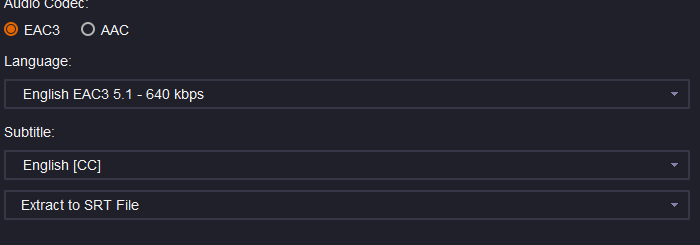

      Same here (6.1.8.1), subtitles on Amazon are not downloading at all. Downloaded The Beekeeper, no subs. Tried 'Subtitles only', got Failed. Streamfab is not downoading the subs at all
      Even an episode of Hogan's Heroes, no subtitles. Same settings I've been using.
