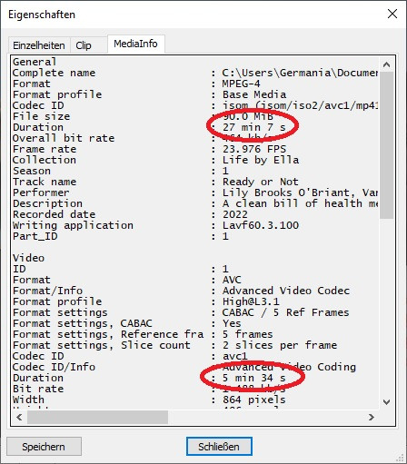

                  I tried "Life by Ella.s01e01" (only sd) with german AAC + forced subs
                  and have 5x [Critical] in StreamFab.log for subs (1 missing segment - 4 retries)
                  and 5x [Critical] for video (1 missing segment - 4 retries), audio without errors
                  The missing video segment is 39 - video freeze at 05:34
                  Click image for larger version  Name:	atv_Life by Ella.s01e01.jpg Views:	0 Size:	84.1 KB ID:	449291

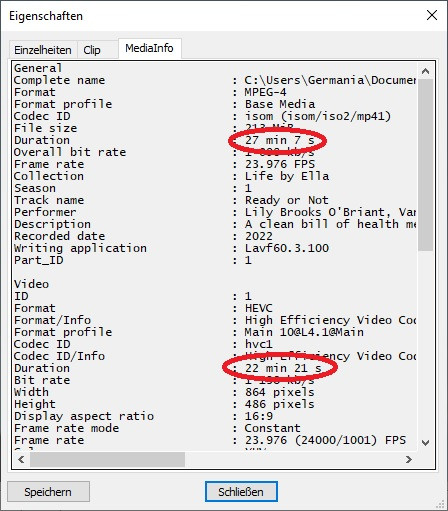

                  2nd try without subs and the same video segment 39 is missing
                  3rd try with H265 SDR and now missing segment 159 - video freeze at 22:21
                  Click image for larger version  Name:	atv_Life by Ella.s01e01_x265.jpg Views:	0 Size:	81.4 KB ID:	449292
                  Can you search for [Critical] in StreamFab.log whether the errors are in the same segments?
