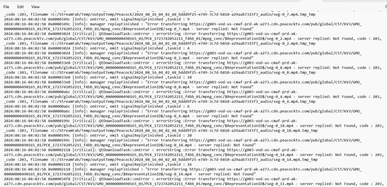

          ...the CDN server is replying (so DNS worked) with a 403/404 not found error.
          I see "server replied: Not Found, code : 203". I don't see 403/404 so maybe my old eyeballs are missing something. dunno
          Also mentioned in the log is audio/seg-0_8.4.tmp" Note if the progress bar turns green when "Downloading Audio" in the beginning - right after "Analyzing" then the download is successful. If it does not turn green then it fails. Hit the pause icon to cancel then the play icon to retry. Might take a couple of retries or still fail after over a dozen retries.

            IMO, YMMV, if the problem is not something they can fix they should have been honest enough to admit it so we could stop wasting our time waiting for a fix.
                  Ahh, sorry. I didn't look far enough to the left to see the 203. Not founds are typically 403/404 errors. A 203 indicates a proxy in the middle, the server not maintaining states between servers or some type of session tracking getting dropped / session change which means the server can't track subsequent pieces of a conversation with the client. CDNs typically spray inbound requests across an array of servers and track the session with some form of a session identifier. If StreamFab isn't aligning to what the CDN server expects then a 203 can occur.
                  Proxies can cause this problem too because they, like the servers, often spray traffic across multiple proxies which can cause the session to appear to change with the receiving server. This could be why he VPN to Boston is working because the VPN may be forcing a proxy lock-in which isn't changing or is bypass your local Internet providers outbound proxy array, which could be causing the problem with session tracking.
                  In any case this all appears to be a session tracking issue.
