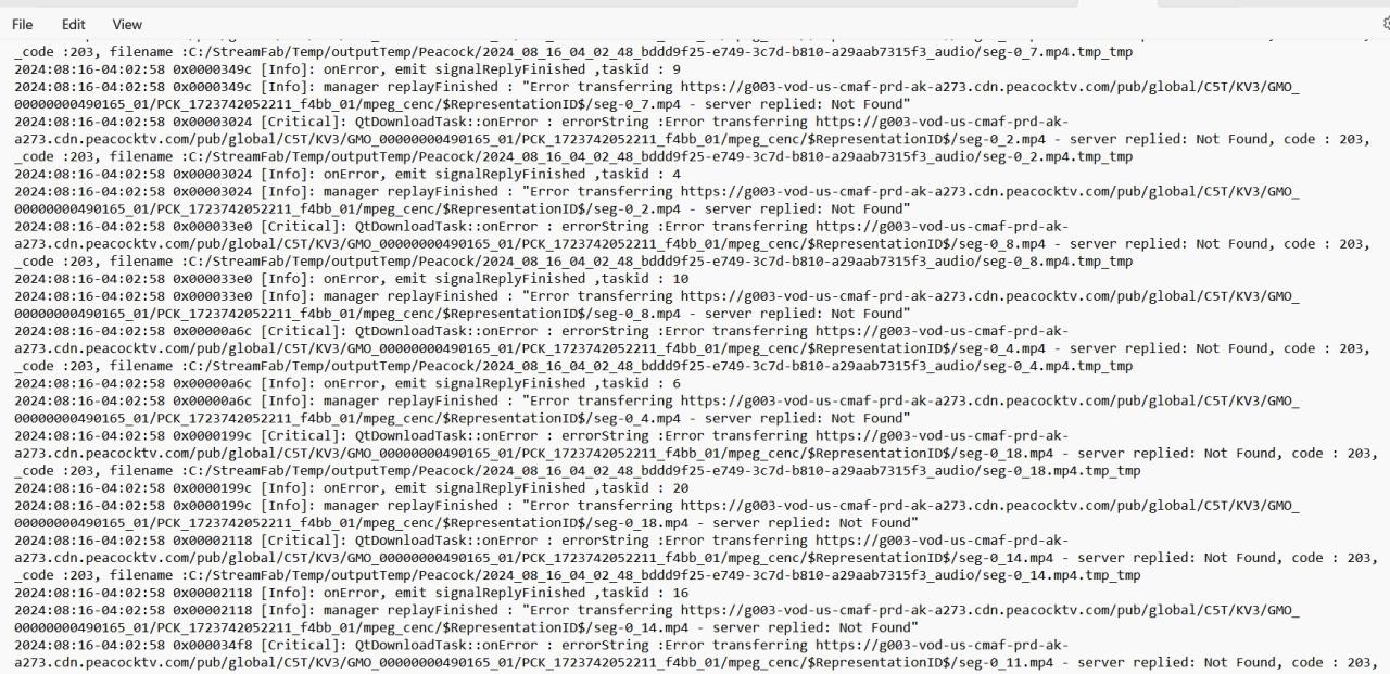

    Originally posted by flylow+ View Post
    My log file after failure appear to be mostly filled with code 203. Appears to be hundreds and hundreds of lines with "Not Found, code 203"

                      " ... server replied: Not Found, code : 203" persists.

                        This is the link Streamfab tries to get:
                        https://g003-vod-us-cmaf-prd-ak-a239.cdn.peacocktv.com/pub/global/0Je/SMO/GMO_00000000490172_01/PCK_1724690663345_8fdf_01/mpeg_cenc/$RepresentationID$/seg-0_10.mp4
                        Code:
                        This is what the link SHOULD look like right from the browser viewing network activity:
                        Code:
                        https://g003-vod-us-cmaf-prd-cc.cdn.peacocktv.com/pub/global/vQJ/pth/GMO_00000000490175_01/PCK_1724962216400_f62a_01/mpeg_cenc/r0/audio/stereo/en/seg-0_10.mp4
                        Why this is happening is still unknown as well as to why only some, not all, users get this.
                        Compare the 2 (streamfab link) & (browser link) and that is why Not found happens.
                        As to why Streamfab does this, it is unknown.
                        There is NO
                        /$RepresentationID$/ it should be /r0/audio/stereo/en/.
                        Good luck in still trying to fix it.
