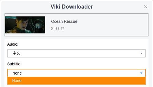

    Before I dig more deeply and spend time looking for a workaround, I'm wondering if this is a known issue with the Viki downloader. Downloading shows with episodes is working well, but when I try to download a movie the analyzer does not give any options for resolutions or subtitles like it does for the shows. The download of the movie does work if I let it run, but you end up with a basic 720p video with no subtitles.

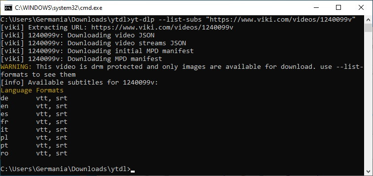

    If subtitles not offered try it with yt-dlp - example:
    Code:
    yt-dlp --allow-u --write-subs --skip-download --sub-langs en "https://www.viki.com/videos/1251332v"
      Ok i tested "Ocean Rescue" and no subs offered by SF
      (in contrast to the series "DNA Lover")
      and i become 1280x536 without Viki Pass

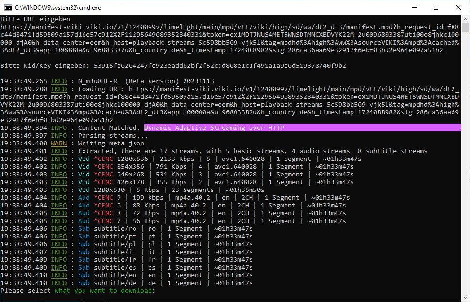

      But subs are avaiable:
      and also included in mpd:
      -= click pic to enlarge =-
      Ergo: It's a bug​
