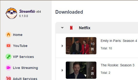

              > I wish out of the people that can download continuous videos, someone would post a screenshot.
              What do you want to see there?
              2 epi The Rookie
              2 epi The Blacklist
              10 epi Emily in Paris (10x av1 + 5x H264)
              6 epi Billionaire Island (6x av1 + 6x H264)
              31 files in the last 8 hours (sf 4x closed + 0x log-out)
              Mostly deleted in sf dl - only 12 are still displayed:

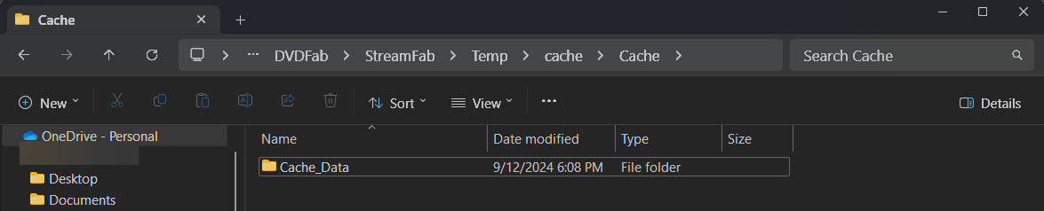

                    Do you mean this folder? Rename to what?

                      #25
                      I would take the whole Temp\cache (2 level up)
                      (cookies self are in Temp\cache\Network)
                      > Rename to what?
                      Whatever - only for the possibility of undoing it if necessary
                      (or move the cache folder to other dir/partition)

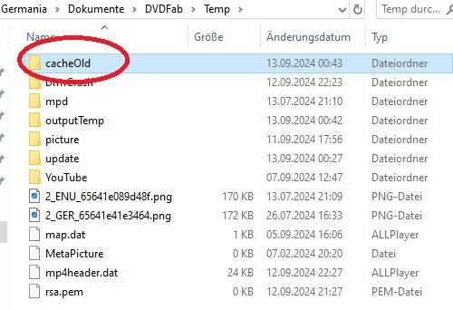

                      Click image for larger version  Name:	cache_old.jpg Views:	0 Size:	55.1 KB ID:	450146
                          > Rename to what?
                          That worked. Renamed to cache.old and now its fine. Thank you so much.
