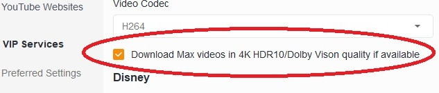

            For Max you can enable this:
