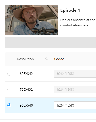

                          ADDED it may be location again as I now found the downloader and still only get 540p
                            Originally posted by Stan001 View Post
                            ok, good, unfortunately, that's one I don't know or have access to.
                            I can only say that the ones I do have are all stuck at 540p, at this time.
                            Looked the same for me - you need to update widevinecdm (currently) by yourself ..
                            Slower but with better result:
