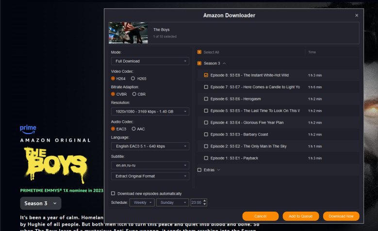

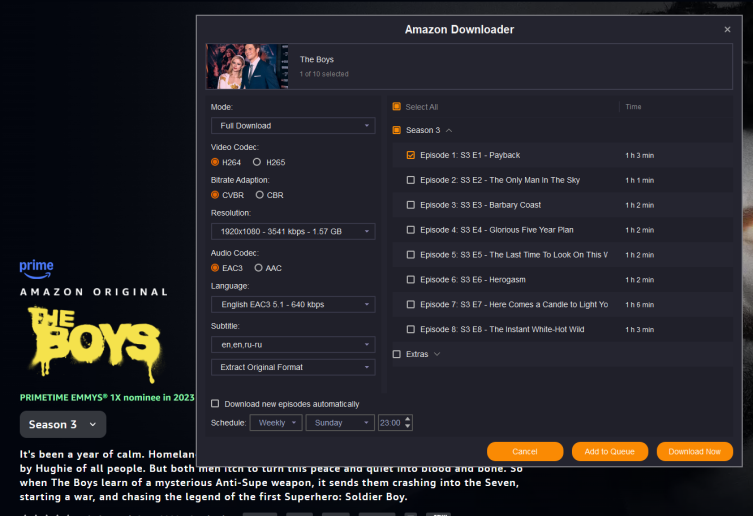

    Of course the additional benefit of this hack is that if you're only downloading the latest episode of a series and are careless like me, not only the correct episode should be selected and analysed, but also you won't have to remember to unclick the first episode of the season and accidentally blow a download credit.
    Before:
    After:

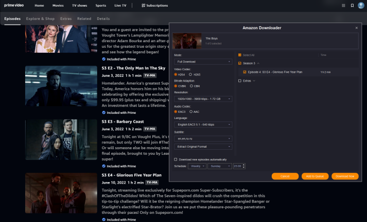

    Haemorrhagic Stroke Repair Level (hard, you'd better get it right!)
    Having read the previous hack, you might be tempted to say "you want me to sit there and count episodes to analyse a single episode, that's just daft?!" and you'll be partially right... We can do better, we can use the name of the episode! If you study the aforementioned function, there is a loop that iterated over the episodes data and constructs the episodes array, while the title of the episode under consideration in that loop is stored in a variable called "title". So what we can do is interfere with that loop so that only the episode with the requisite title gets added to the episodes array. You will notice that the actual adding of the episode to the final array is done on line 172, and that's where we want to clip. Again, as our luck has it, python provides a way to do a partial string match, and we can make our life even easier by doing a lower case match so we don't have to get the CaMeL casing of the title correctly. The way we clip the required episode is by saying only add episodes with lower case titles that match the string we give you. So, let's say we want the episode called "Glorious Five Year Plan" to be analysed, you would modify from
    Code:
    episodes_array.append(e_obj)
    to
    Code:
    if "five year plan" in title.lower(): episodes_array.append(e_obj)
    obviously the string you give in the if condition has to be sufficiently unique to single out the episode you're after, otherwise you're not going to get the correct result! And I've not tested this with anything other than latinised titles, so it might not work for other languages, which is why it's still a hack, and not a fix
    Before:
    After:

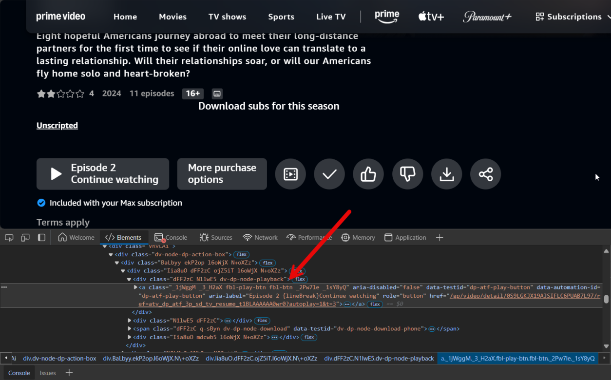

        Great job but instead of using the title variable, wouldn't it be better to have it use the class for the play button? You start the episode you want to analyze, stop the episode, now the play button is set to that episode and you analyze it.
        The script can find the play button class, get the href, and then you filter the array to the play_url instead of the title. Very busy onboarding a couple of new hires today but i may try my hand at it sometime this week.
          Potentially yes, but I'm working with a list of episodes that the function has already parsed from the episode list, and selecting the episode based on the "Continue watching" button could lose episode information and can be quite messy... You could just pluck out the name of the episode from the button and match the name in the list, I suppose, but that's getting messy as well. In any event, I suspect episodes_data (the sole argument to the function) has a way smaller scope than the entire page, so you'd have to hack some upstream function, if not several... extra mess... And just plucking out the episode from a list based on its name doesn't actually require you playing the episode.
