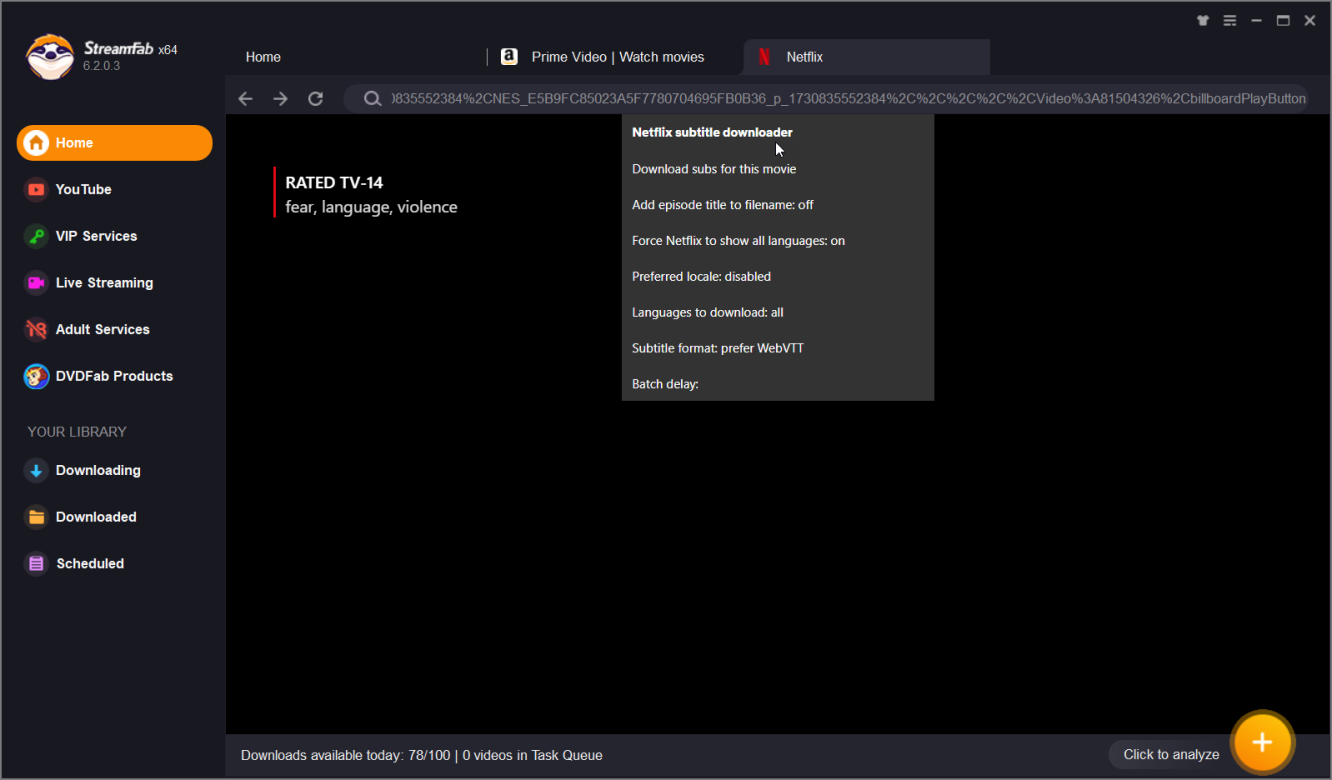

              Because StreamFab now uses a full featured Chromium browser, you can install extensions.
              I have installed BitWarden and ViolentMonkey. In ViolentMonkey, i installed Amazon Subtitle downloader and Netflix Subtitle downloader
              So you can download external subs from within StreamFab and all modern players can use them or you remux them into your files manually
                Good to know. Often times though I might realize I am missing the subs months later as I watch the content. Knowing I could easily double back is a plus.

                  #23
                  ... and after editing the Amazon subs downloader script to make it stop bastardising pristine TTML into SRT and appending stupid things to title (as well as making it recognise [cc] subs properly), it works rater well. Kudos on the legwork!
