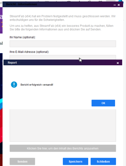

    But I failed to get SF 6.2.0.4 working. The installation process runs fine, and the application fires up succesfully, but as soon as I try to select "Amazon" to get to the login-window for amazon, SF crashes instantly.
    I tried to "uninstall" SF 6.1.9.9 and clear the cache, and reinstall SF 6.2.0.4. Same reult.
    I even tried on a "fresh copy" of Win 11, where SF never was installed bevore, same behaviour.... ...SF starts and seems to be "up and running", but no way to log into amazon, this causes a crash, even before I have a chance to log in at amazon.
    I tried the "full installer" (streamfab_x64_6204.exe) as well as the online installer (streamfab_online_6204.exe), same result.
    Anyone has a clue? As far as I read the forum, others managed to get SF 6.2.0.4 running and to do downloads.... ....I have no idea what I missed.
    Logfile is attached.

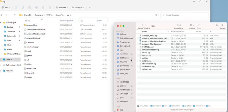

    Also, maybe check the streamfab.log, you never know it might point to something, even crashing. You could check the other logs as well.
    Most people only now do the offline installer. And if an older version exists, uninstall using streamfab uninstall, and then install again.
    I Always use the 64x version (here).
    Location of temp and log files.
    Code:
    %HOMEPATH%/Documents/DVDFab/StreamFab/Temp
    %HOMEPATH%/Documents/DVDFab/StreamFab/log

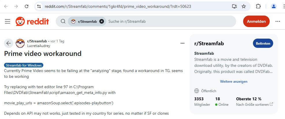

        does Amazon not work in SF 6.1.9.9 ??
        After the amazon website change analyze fails (info)
        so you need fix the script => info
        (your source - thx again)
            I will take a look at that, tanks.

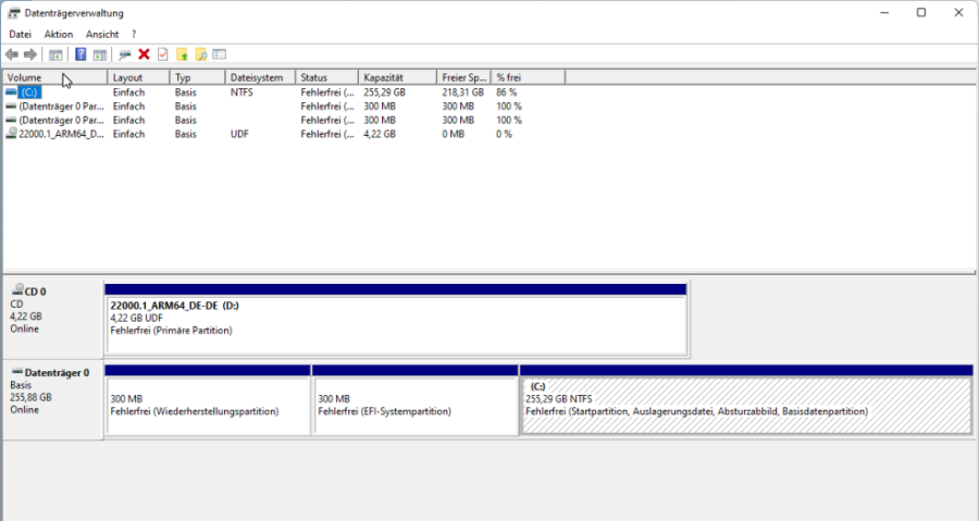

                    Please check it in StreamFab Common Settings, Documents directory free space or the settings of Parallels.
                      The path "//Mac/Home/Documents/DVDFab/StreamFab/Log"​ points to a directorty that has 96GB of free space, therefore I do not understand the "space is unavailabe" message.
Name:	Bildschirmfoto 2024-11-13 um 15.13.56.png
                      The "C" Drive shows 218GB availabe.... ...weird.

                        C Drive space available... ...no idea where the "space unavailabe" message comes from.
                          ok, I now habe seperated the two worlds "Mac and Windows" running on Parallels VM. Win11 now has no whatsoever access to any Mac devices and vice versa.
