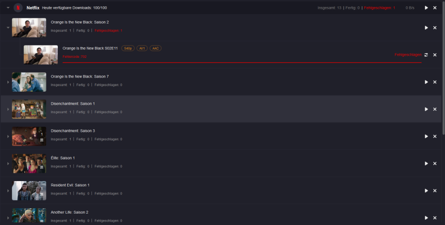

    On some series episodes I get the 702 error after remux. Download fine but after remux it fails.
    These are some affected series (and more). Most episodes were fine.

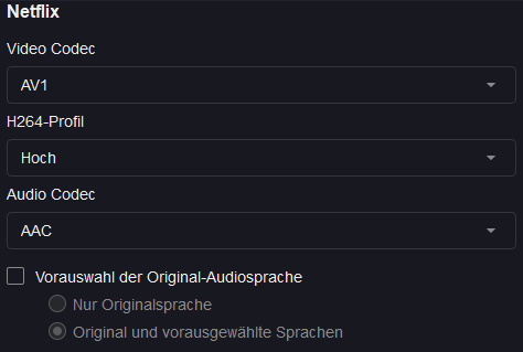

    My settings:
    - MKVToolNix (tried ffmpeg too)

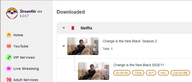

      1st test was AV1 720p AAC mkvtoolnix ..

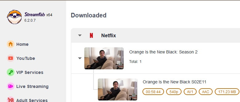

      .. then I noticed 540p in your pic
      No problem detected - so log needed for more suggestions​
