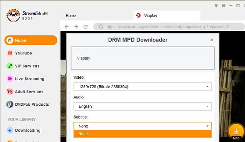

No subtitles...
This topic has been answered.
    DRM MPD No subtitles...
    Anyone else having problems with missing subtitles?
    This applies to viaplay.no, download video works fine.
    The last time there was something wrong with DRM MPD there were many download sites with the same problem.
    Worked fine yesterday but not today.
    Also can't get subtitles on previous downloads that had subtitles so there must be a change on the website.

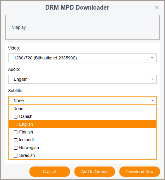

      Sounds plausible - but how we can you be helped now?
      for 2 minutes:

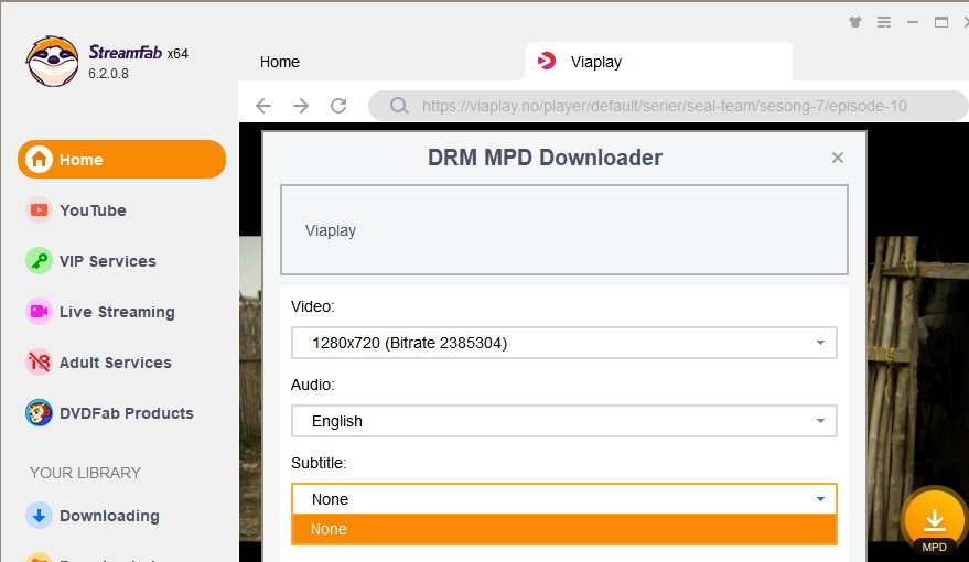

              viaplay subs
              I can confirm thaf SF don't offer subs for "Seal Team" from viaplay.no
              Looks like more series (3 tested) affected and some movies also ..
              Some titles offer mimeType="text/vtt" - thats detected by SF
              and also (some titles only have) mimeType="application/mp4" codecs="wvtt"
              that's not detected by SF
              Ergo: SF offer subs if vtt + wvtt in mpd
              Click image for larger version  Name:	viaplay_subs_detected.jpg Views:	0 Size:	381.2 KB ID:	455191
              SF don't offer subs if only wvtt in mpd:
              Click image for larger version  Name:	viaplay_subs_not_detected.jpg Views:	0 Size:	333.6 KB ID:	455192
              -= click pic to enlarge =-​

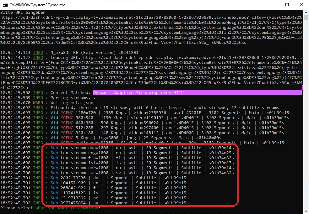

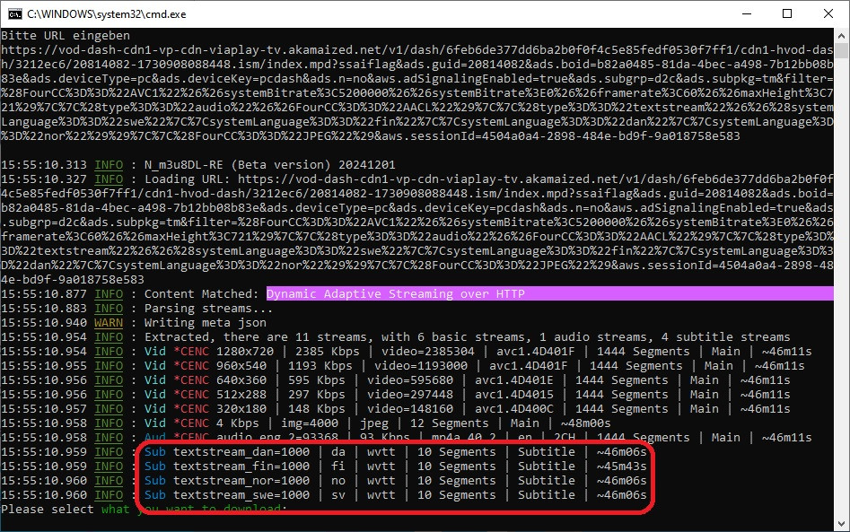

                  btw: If you have the mpd url (info) you can use N_m3u8DL-RE to dl subs​
                    Ok, don't understand much of N_m3u8DL-RE.
                    Takes time to learn this.

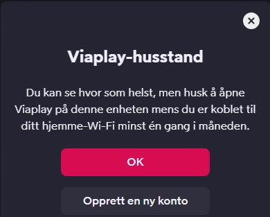

                      I was on the road earlier with 6208 ..
                      .. but something else surprised me:​​
                      Click image for larger version  Name:	viaplay-husstand.jpg Views:	0 Size:	25.6 KB ID:	455207
                      I already had your error - the same title was still on in the regular browser

                              Tried again now, everything seems normal again with subtitles.
                              Must be something they were doing today that made subtitles unavailable.
                              Thanks anyway for your help.​
