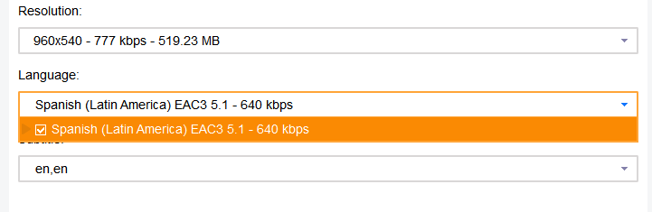

    As said in the title, it's a weird thing with Netflix trying a movie that only gives audio of Spanish. Checked in Netflix and in settings. Other movies ok, I feel most will say it's an issue with the certain movie, as so far other movies tried give English.
    Just doing some tests, the trouble movie is Daddy Day Care.
    Otherwise, no issues such as endless analyzing or not analyzing, etc ...
    Also, so far other programs offer English audio, also now did clear cache and logs.
    Tried with 6208 and 6209 same issue, only Spanish audio.

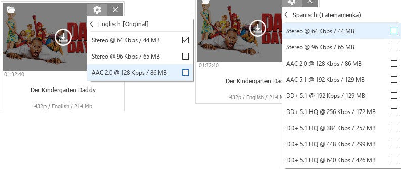

    You will see all the languages offered for your selected audio codec EAC3.
    Since the beginning of Nov. many NF titles only have EAC3 for the original language
    and offer other languages only in AAC - this movie is from USA but english only AAC
Name:	nf_Daddy Day Care.jpg
    If you think it's an SF error .. nope - in Recorder the same:​
Name:	nf_Daddy Day Care_rec.jpg

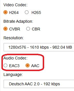

      Click image for larger version  Name:	P8d0HtFxSZOo8Wdmvt-TKQ.png Views:	0 Size:	4.6 KB ID:	455964

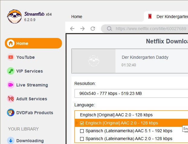

        OK, NEVER MIND. It's under Netflix, the setting that needs to be changed.
        Should SF not give all audio even if I had EAC3 picked. Now it seems like a huge pain to have to change back and forth depending on the movie.
          If your preselection is EAC3 it shows only EAC3 ..
          .. this is exactly what I expect from this setting.
