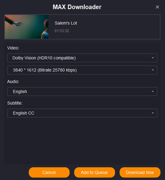

    'm not sure when this started as I haven't grabbed from Max in a few weeks but I noticed it over the weekend. No matter what I download, movie or TV series, it has the subtitles duplicated in the SRT files. It's almost like it's trying to grab a regular and the cc subtitles and putting them into 1 file. However when given the option of what to download, there is one option to select. I'm getting the same results from 6.2.1.2 and 6.2.1.0. And unfortunately due to formatting differences in the lines cannot be easily be removed as duplications. Does anyone know how far old of a version of SF may be able to download correctly? Or I'm guessing this is more of a Max issue.

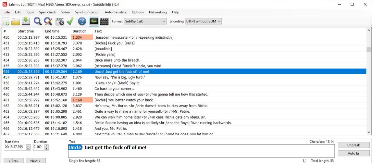

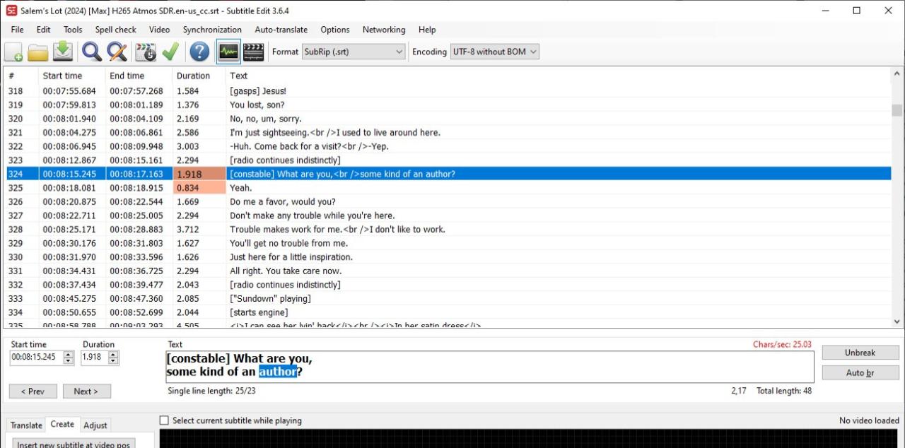

        I tried the Merge Lines with Same texts and it did help with a lot of duplicates, however sometimes it fails because the lines will be "[constable] What are you, <br /> some kind of an author?" vs "What are you, some kind of an author?​​" so the <br /> throws it off, or it may be "-What are you, some kind of an author?​​" so the - messes it up. I also can't do a remove same time codes because the are slightly off at 8:14.911 vs 8:15.245.

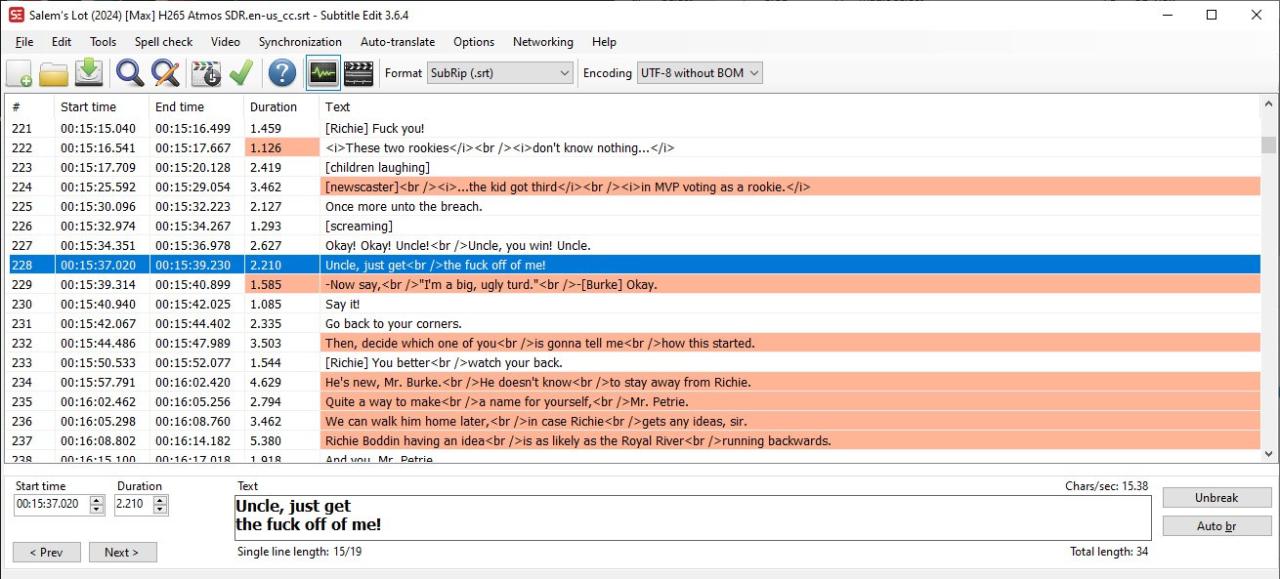

        I tried the extra commands and it did clear up a lot of the issues so thanks for that! However there are still duplicates due to the change in punctuations sometimes as seen below. Any suggestion for that?
        Click image for larger version  Name:	lot.jpg Views:	0 Size:	92.1 KB ID:	457022

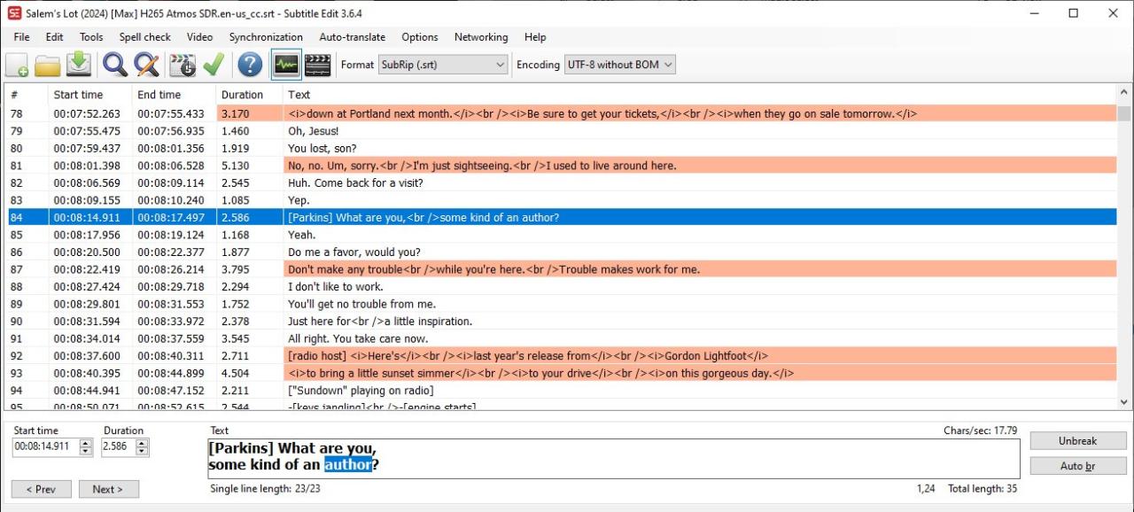

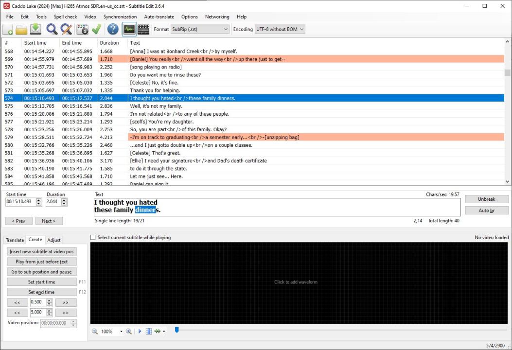

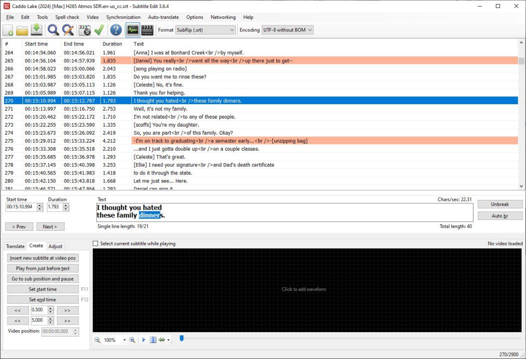

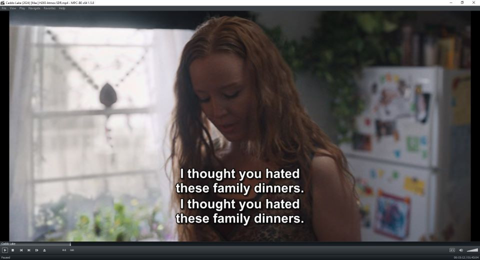

          It is not a player problem. You can see it right here in the SRT file the lines are duplicated at line 270 and line 573. And as you can see my post above even on Salem's Lot lines are duplicated with slightly different punctuations.
          Click image for larger version  Name:	cado2.jpg Views:	1 Size:	122.5 KB ID:	457028

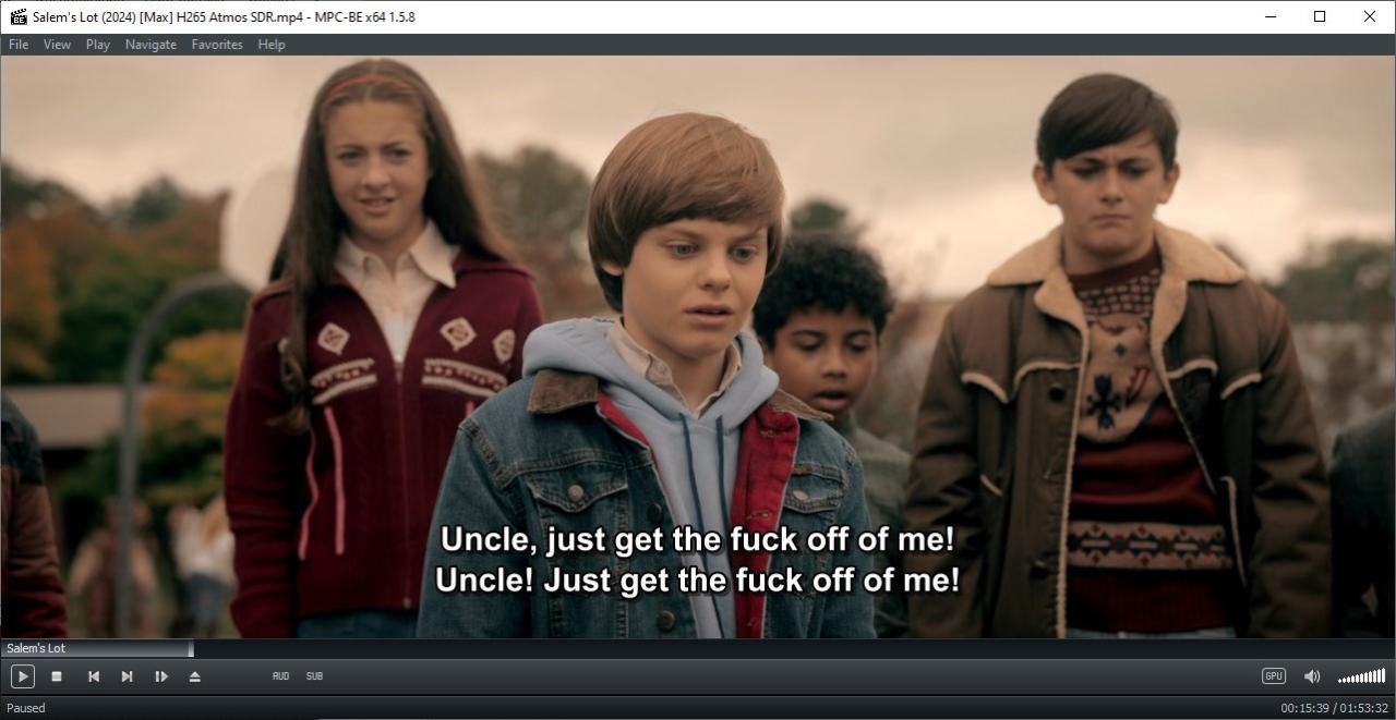

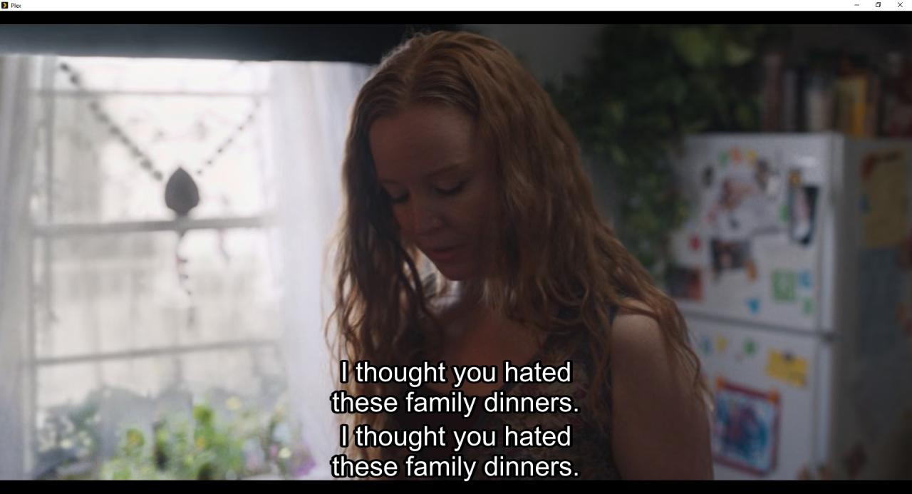

          And here we are in Plex showing the duplicated subtitles. I'm not sure why VLC doesn't display them, but they are definitely there.

                I cleared the temp folder. Closed out SF and reopened. I deleted Salem's Lot and redownloaded it. Still messed up. I even tried downloading a higher quality one, same result. As you can see the time stamps are a fraction of a second off from each other and they are formatted differently with "Uncle!" and "Uncle,"

                And here is an even weirder one. Same spot in the file, nearly identical time code, but one has the subtitle as saying [Parkins] and the other says [constable].
                Click image for larger version  Name:	lot4.jpg Views:	0 Size:	125.3 KB ID:	457047 Click image for larger version  Name:	lot3.jpg Views:	4 Size:	114.8 KB ID:	457046

                  ​It happens that I also have the Salem's Lot downloaded with a date of 2024.X.8 - so with some older SF. English CC srt file also has exactly 2802 lines, 195 696 bytes. The last few lines from your screenshot are identical.
                  The example conflict in this file is on lines 240:
                  Code:
                  00:16:22,190 --> 00:16:25,026
                  We take people at their word
                  here in the Lot.​
                  and 468:
                  Code:
                  468
                  00:16:22,607 --> 00:16:24,609
                  here in the Lot.​
                  ... among many other.
