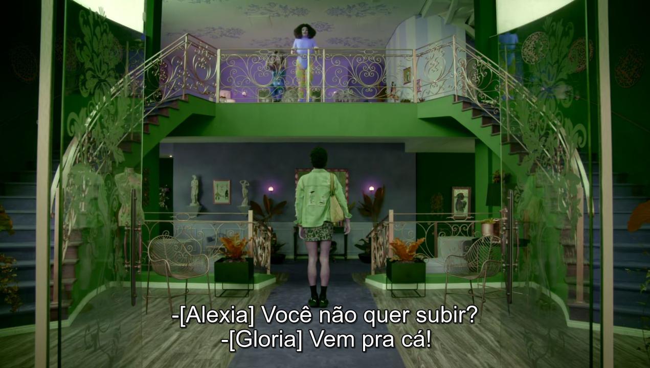

picture color in green
    Netflix picture color in green
    after i download any video from netflix the color is green of any color
    any solution ?
    Dolby Vision Download and no Dolby Vision supported Display ?
    HDR10 would look pink and Dolby Vision look green if your player cannot decipher or tone map.
      even if i choose any other option i got Dolby Vision
      how to adjust setting to get hevc without dolby so any display can play it normally
        NF offer hevc only as HDR or DV - change in NF VIP settings - Video Codec
        But it's also possible that your device/player shows HDR in pink
        more info here
        btw: I can't test HDR because I've only NF Standard plan ..
        .. it's not offered without Premium plan
        H265 SDR is no more offered for NF since many weeks ..
        We confirmed that Netflix removed the H265 SDR stream video files.
        And the option also will be removed from StreamFab.
