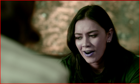

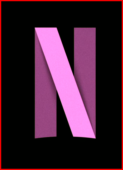

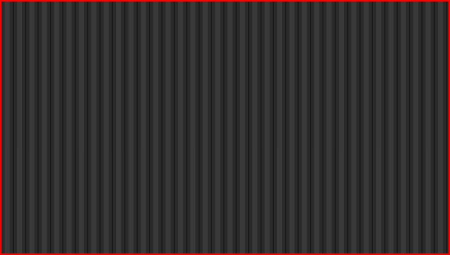

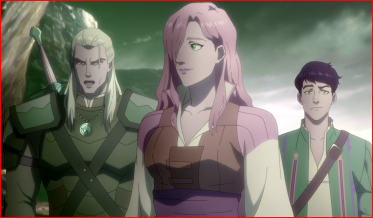

    I went to download some TV series today from Netflix and the colours are all coming in various shades of purple?
    This happened on various series, the witcher (anime), the recruit and the night agent. I have attached some images of what is going on, there's some weird pattern appearing at the beginning of the series episodes and then a purple netflix and then when the episodes start, you can see from the screenshots the colours seem to have all shifted towards the blue-end of things.
    Thx !
    Then your Display or Player don't support HDR
    HDR10 would look pink and Dolby Vision look green if your player cannot decipher or tone map.
    see also: here
    It is necessary to change the VIP setting for NF Video Codec
    Only change selection is useless - see here: SF 6221 - NF Selection looks fine but dl wrong Codec
      see also: here
      Thanks - so wait for an update then. I can live with that, thanks G, most appreciated for passing the link to the original post!
