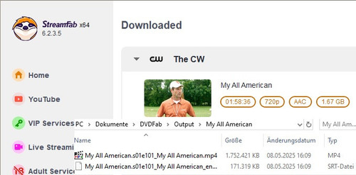

          Also, notice it attempts to save as a show, S01E101, and it's a movie.

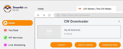

                      StreamFab 6.2.3.5 Changelog
                      Fix: A problem that the the file name customization are displayed incorrectly when downloading videos from CW.
                      A minimalist selection dialog ..
                      (it was never possible to deselect subtitles)
                      .. and the movie title is not really better:

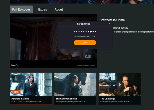

                        Has something changed on CWTV today, both 6234 and 6235 get stuck on analysing the last item (setting aside that SF thinks there are n+1 items when there are only n, maybe that's the problem?)
                        ok, found where the +1 comes from: it's the "Extra"
                        Click image for larger version  Name:	image.png Views:	0 Size:	133.7 KB ID:	462795
                        Code:
                        2025:05:08-15:49:37 0x00008410 [Info]: Url: "https://images.cwtv.com/feed/app-2/video-meta/apiversion_22/device_web/guid_24008f14-5911-4697-8adc-0c9f3d637db5"
                        2025:05:08-15:49:38 0x00008410 [Info]: Url: "https://images.cwtv.com/feed/app-2/video-meta/apiversion_22/device_web/guid_830c65a0-f8c9-47cd-ae78-eae1d0304def"
                        2025:05:08-15:49:38 0x00008410 [Info]: Url: "https://images.cwtv.com/feed/app-2/video-meta/apiversion_22/device_web/guid_0b88a1f8-44be-4179-be21-6c7d687bf07a"
                        2025:05:08-15:49:39 0x00008410 [Info]: Url: "https://images.cwtv.com/feed/app-2/video-meta/apiversion_22/device_web/guid_eef0d5bc-74c4-41f0-8dae-7bcc7c3d6d15"
                        2025:05:08-15:49:39 0x00008410 [Info]: CWTV check add queue state, meta is valid : true
                        2025:05:08-15:49:39 0x00008410 [Info]: CWTV meta current play id : "24008f14-5911-4697-8adc-0c9f3d637db5"
                        2025:05:08-15:49:39 0x00008410 [Info]: Url: ""
                        and ThePlatform seems to have been reworked so yt-dlp is a no-go natively...
